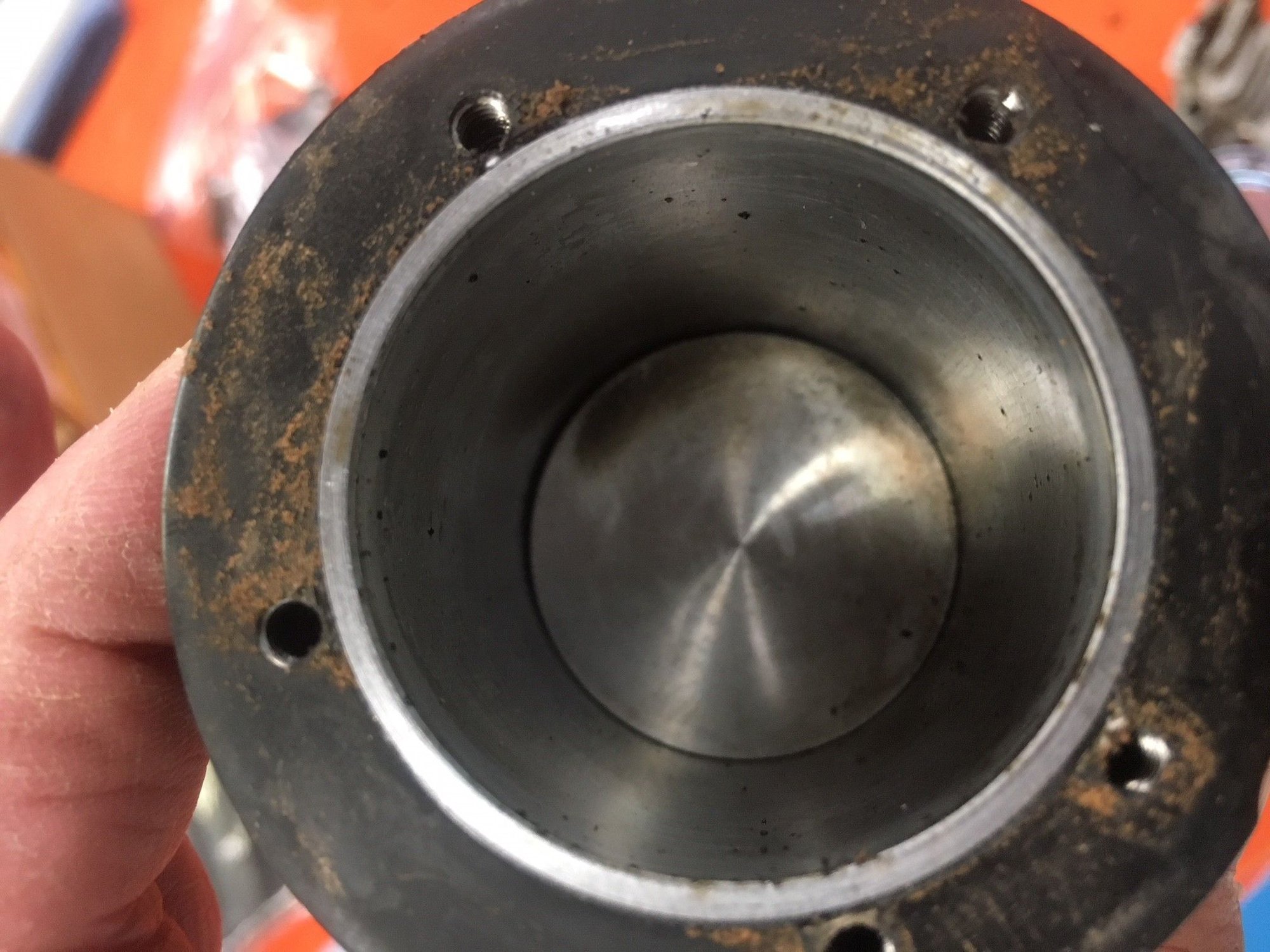

Hopefully we can avoid an oil war here, as this is mostly a emotion-driven subject.
I too have been running Redline 2-stroke racing oil in all my gas engines for 10 years now. This includes a Moki 250 with well over 250 flights on it. I run a 50:1 mix and have NEVER had a oil-related engine failure. My sample includes:
Moki 250, 3W 170, 3W 150, DA-50, DA-85, MVVS 80, G38, G62, and G26. I also break my engines in on Redline for what that's worth. In my oil studies over the years I came across a very in depth study by Ken (Big Bird) and one of the takeaways from his extensive testing was some oils contribute to the combustion process and some oils do not. One of his conclusions was "...the amount of carbon in an engine seems to be related to the quantity of fuel burned for a specific oil brand." I know from first hand observation that Amsoil use results in more carbon deposits than Redline. I do not have the knowledge to say that's good or bad, but personally, I want to minimize carbon buildup in my Moki. With that said, I offer the following picture of one of my Moki cylinders. This is the engine with more than 250 flights on it:
Sorry that image turned out so huge. We are looking at this because I stuck my Moki into the ground on the nose of my CARF Corsair last year.
Anyway, this is my oil story and I'm positive others will have first hand observations to support their contention. But as to Redline being bad for your engine...not in my experience.

Greg, thank you for your response. My experiences with Amsoil was similar, with carbon buildup and sticking valves. The valve problem was so bad that I was close to writing Moki's off my list. This was several years ago. Now at that time I was not using seafoam, which adds a variable to the situation. (1 oz/gal) I have no emotional attachment to any oil, I want what is best for the engine. -Tom
