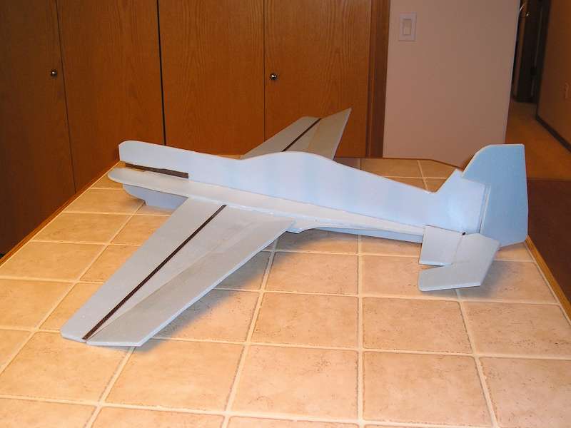

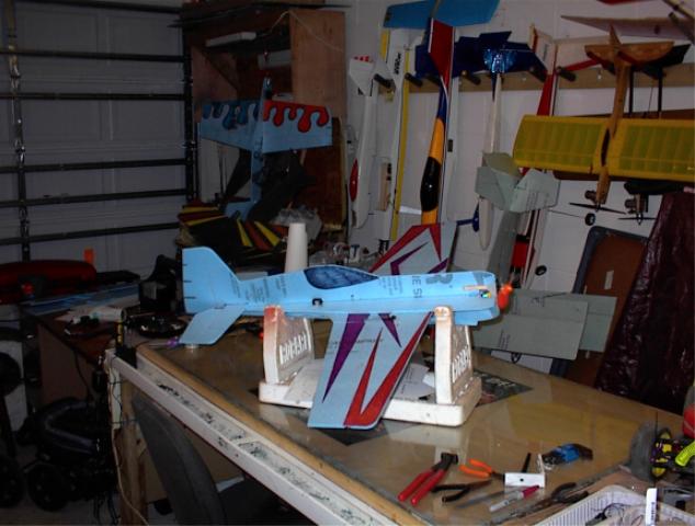

I have started putting together a www.3DFoamy.com SU 26 MX. So far it looks pretty good. It is 4.3 oz so far. It will be my usual GWS 350D, 1200 Kokam, 3 HS55's, and it will have landing gear. All up weight with paint should be around 12.5 oz.

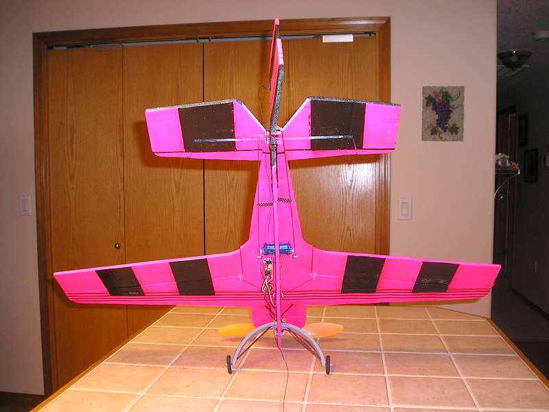

Hey I just finished mine here are some specs.
himax 2015-5400
C.C. pheonix 10 esc
GWS D (6.6:1) gearing
13x6.5 GWS prop
TP 1300 2s
It weighs 11.9 oz with no landing gear.
Havent flown it yet the weather wont let me, but I spooled it up in the garage and I think it will hover at half throtle.
Ok had to edit this I just flew the plane it does every thing nice the only thing I didnt like is that it tourqe roll while hovering real bad I had almost full right aleron in it to get it to stop. Im going to try a 11x4.7 prop with tp 1300 3s to get the thrust I need with the smaller prop.hopefuly that will take care of the tourqe problem.

I do, I'm at work now so I'll have post them later. I finished the SU26 up last night, when I was going back to the plan for the CG I discovered that some how I had placed the too far aft, like 2 1/2" too far aft, Dont ask how that happened. After I was over being stupid, I elected just to finish it and fly it as is. All up weight ready to fly is 12.6oz. Well, I just got done flying it in the hanger at work. It flys real well, nice slow flight, way easy to harrier, alittle wing rock, but not bad. I'd say its the easyest plane to hover that I've had yet, that may be due to my skew up making it a shorter tail, and longer nose moment. All in all I'm impressed with the airplane, it looks great in the air. I'm going to build another one correctly.
I'll get some pictures posted later

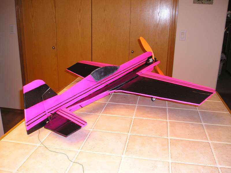

Old 03-27-2004 | 11:02 PM
FNG's Avatar
FNG
Joined: Feb 2003
Posts: 180
From: Vancover, WA
Default RE: 3DFoamy.com SU 26 MX
Picutes

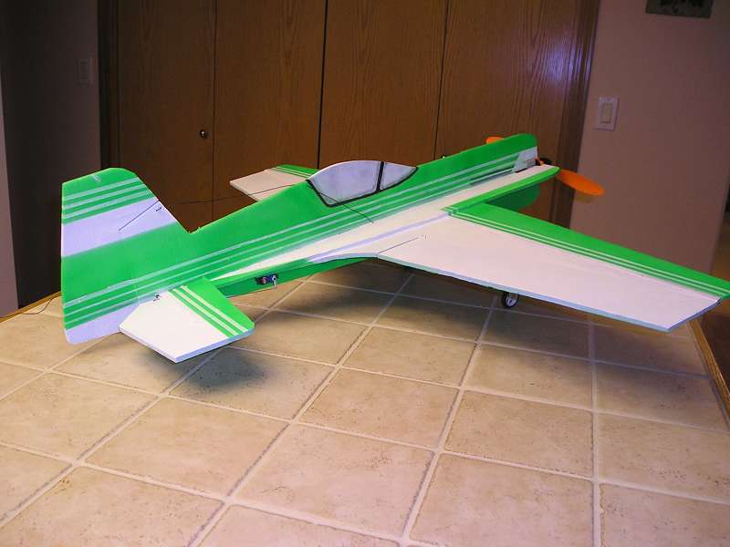

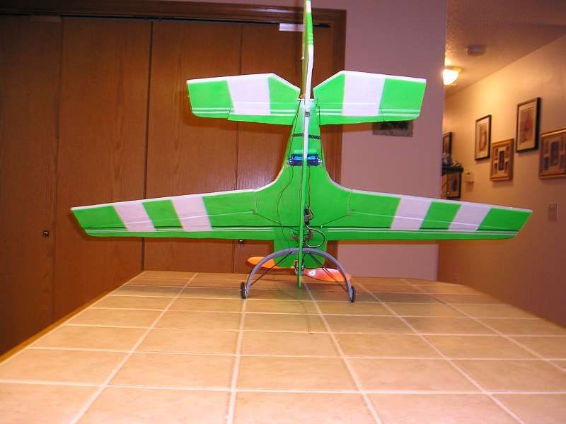

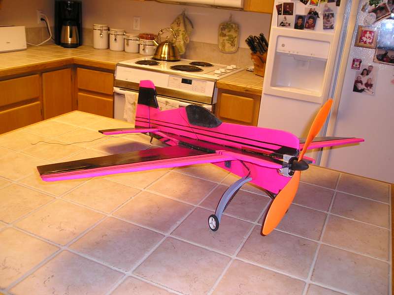

Well I built another SU26, this time I put the wing in the right place [:@]. I printed out the tile plan this time, it came out to 37 1/2" span, that was ok, I want to go alittle smaller anyway. I moved all the hinge lines 1/4" forward and moved the inboard ends of the ailerons in a bit too. AUW 12.2 oz, with GWS D gear box, Brushed Orion Baja (Lose mini T, truck) upgrade motor. 3 HS55, TP1320 3S batt. CS 12 ESC, GWS 4 ch Rx, 1 1/4" MPI wheels, 1/8" carbon tube gear legs.
I'll fly it later today

Flight report:
It flys great, does some pretty incredibal snaps, hover/harrier all day long, climbing inverted flat spins, does have a far amount of knife edge coupling required, harrier rolling circles etc, roll rate is faaaast. It looks pretty cool in air although I'm NOT real crazy about the color..... like the green/white better.
This thing snaps so hard I threw the battery off in flight. I always used the hard plastic to hard plastic style velcro. I think I'm going add a zip tie from now on. I was about 50' up just tossing it around to see if I could brake it and I saw the TP 1320 falling to the ground. Major bummer. Time will tell if the battery will be ok or not. The plan did a realy nice blender like spin the ground. The CG with no battery is only slightly more tail heavy. When the battery left I was at full aileron, full rudder, and full nose down. The only damage to the airplane was the aileron horns where loose. I flew it again last night in front of my house with a different battery, its all good. I'm going to fly indoors tonight.

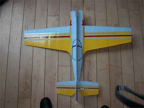

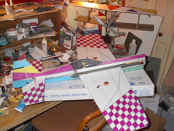

Hey there, I'm working on putting together the Su26mx from 3dfoamy as well.
I was wondering if the added side profile helps with wing rock in relation to the main fuse? I had built the Sukhoi from foamyfactory but the wing and tail wobbled so much I put diagonal bracing between them, I was wondering if I needed to do the same with this one?
Also, are you guys flying two aileron servos, and if so how are you attaching them? (sinking them in, or surface mounting them on the bottom.
I'm covering it with a pretty light vinyl decal material, and it looks great. I'll see if I can get some pics on here.
Old 04-12-2004 | 11:41 AM
Posts: 182
From: Raleigh, NC
Profile

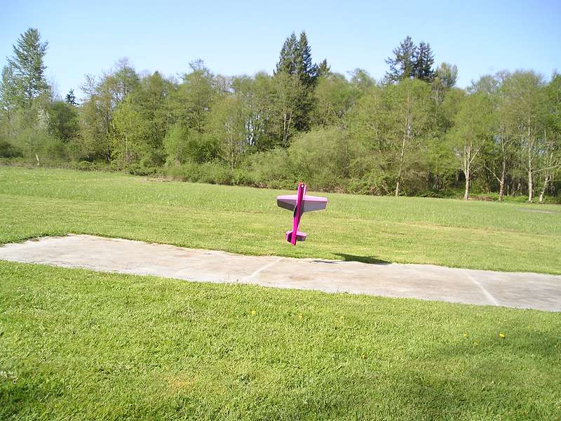

Heres a couple of flying shots, this is with my new 2015,4100 setup. (it did all this no problem with Orion Baja as well)
