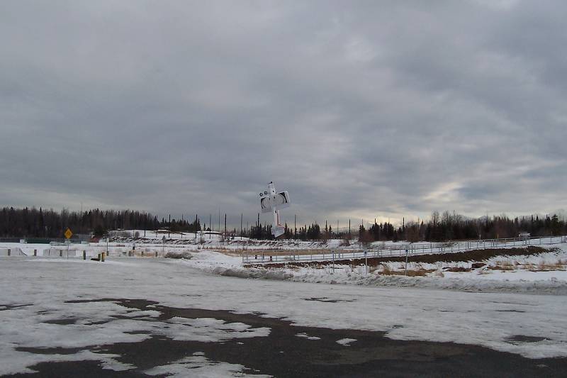

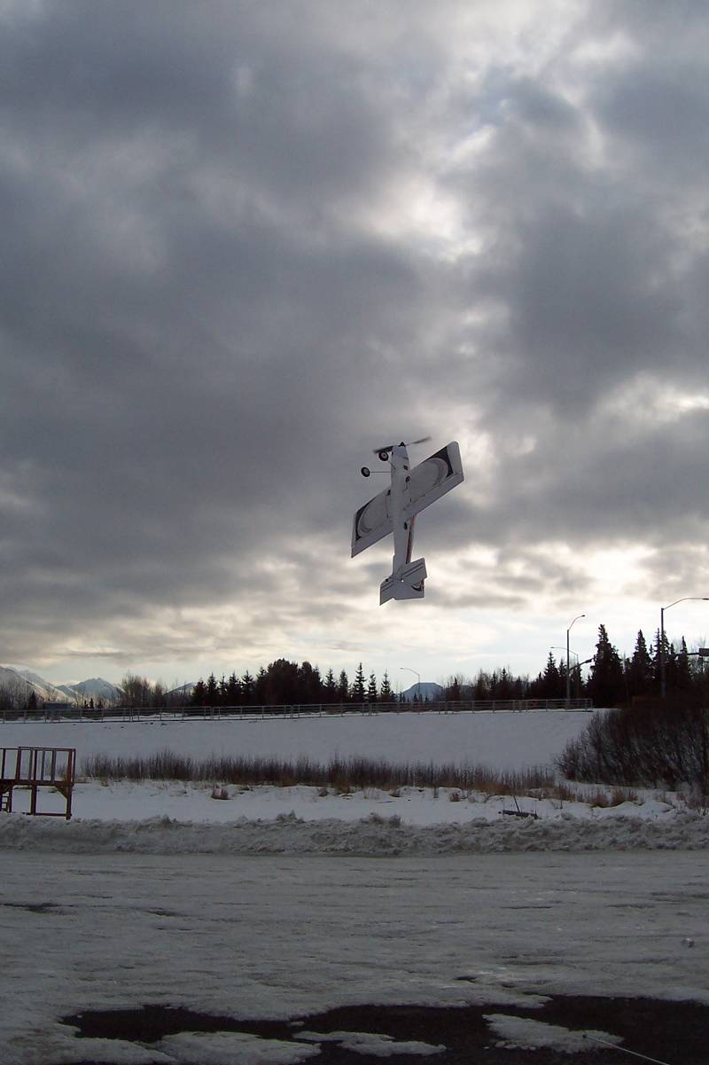

Old 03-24-2006 | 04:06 PM
Joined: Aug 2002
Posts: 135
From: anchorage, AK
Default RE: typhoon 3d esc
Heres some pics of thismorning, Jeti esc on stock motor, 3 cel lipo 2100 from His and Hers hobbies. It hovers just a hair over 1/2 power. Im looking for some better servos and maybe ill change radios in time. ill replace the motoer setup If this one takes a dump.
