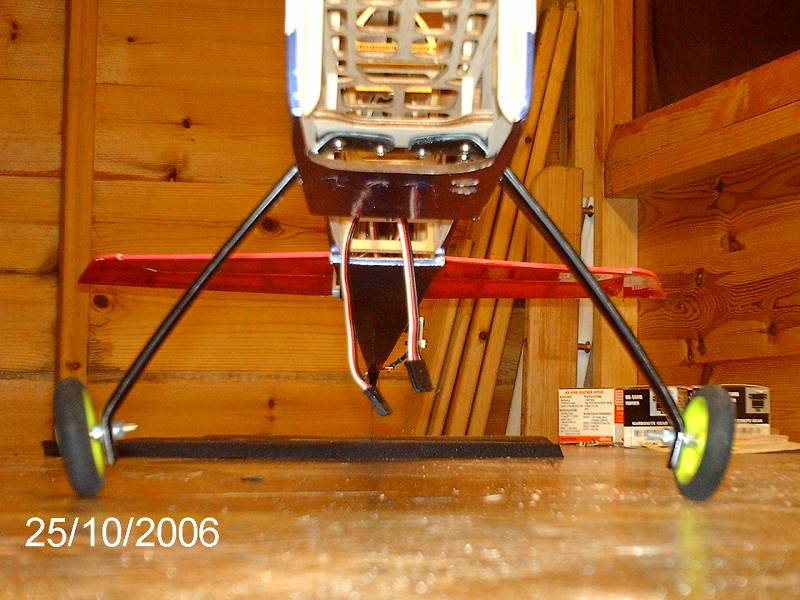

Hi Flitonusa, thanks for the reply.
Here is a photo of the problem.
It actually looks like the angle of the mounting part of the legs is at the
incorrect angle as I had to remove material from the fuselage sides
in order for them to screw to the plate correctly.
As you can clearly see this fault has made the undercart completly useless.
Best regards.
Best regards.

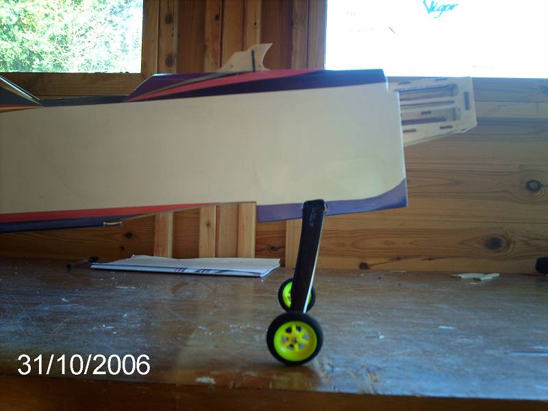

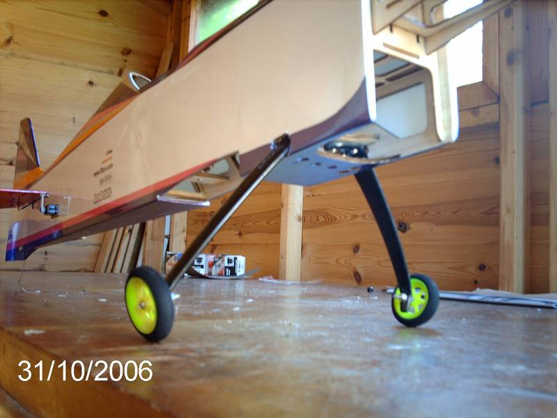

Hi again,
I have attached a couple of better photos for you.
When I say undercart, this is short for undercarraige and I am refering
to the undercarraige legs.
Yes I drilled on the correct marked points to line up with the existing holes
in the ply plate.
When I mounted the legs through the openings, I had to remove material from the bottom of the existing holes to allow the legs to fit correctly.
In fact you can see the extra removed area in the photos, as the legs are touching the lower fuselage sheeting.
This led me to believe that the legs had been moulded incorrectly.
I know you have to ask many questions, but to give you some backround, I have been
building for nearly 30 years which includes giant gas planes to turbine scale helis so
a small electric plane shouldn't be any trouble for me.
Look forward to your reply. Thanks again.
in the ply plate.

Join Date: Jun 2003
Location: Irvine,
CA
Posts: 33
RE: Fliton Rogue undercart problem.
Hello again,
Thank you for the pictures. On our first batch of Rogues, the drill holes did not line up exactly, which is causing your camber and the need to remove parts of the fuselage. The holes on the gear plate are about 3mm too far inward.
A simple solution would have been to drill new holes on the gear plate using a small 1mm drill bit and the holes on the landing gears as guides. It is not too late to do this but because part of the fuselage that supports the landing gears was removed (per your pictures), it may be a little harder to line-up correctly. You can also opt to leave the gears as is, which will not negatively effect the airplanes performance in any way.
Hopefully this answers your question. If you have any other question or need immediate assistance, please just email us: [email protected]
Thank you.
Thank you.

I appreciate your comments on the holes in the mounting plate being drilled in the
wrong place, however this doesn't affect the camber on the wheels as the legs are screwed properly to the plate.
I have studied photos of other Rogues including the RCUniverse review and your own website and I
can see the problem.
If you look at the photos of mine from the front, you can see there is an inward curve on the legs(not the sweepback),
whereas the other Rogues have straight legs.
I have got round this by heating up the legs and gently straightening them which has put the wheels at the correct angle,
while still retaining the sweep back.
This isn't a perfect fix as I don't know if the legs will be weakend.
A better resolve would be a pair of correctly moulded legs!![>:]
I will be test flying it this weekend and I'm hoping the flight performance will make up for this niggly problem.
