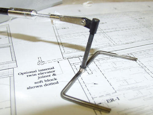

OK, we wanted to mount the elveator servo upside down and the rudder servo right way up on the servo mounting plate. Only problem with that was with them both sitting on the SM plate, the line from the centre of the ele horn hit the back of the upside down rudder servo. So we put spacers in to lift both servos up to give us the clearance we needed. Cyano'd in a 1/4 liteply spacer plate for the ele servo that you can see in the pic, but rather than cyano the 3/8 rudder spacer in, we've screwed it in from this side so that in the event that we need to get it out for adjustment or whatever, we don't have to take the canopy off to get to it. So the rudder servo is screwed to a 3/8 liteply plate which is in turn screwed from the other side to the servo mounting plate and that's the screw heads you can see there. Sounds much more complicated than it is in practice
Oh and yes, before you ask we did use left hand screws to counter the engine torque

Stratman just for you
Make sure you lock the clevice solid this end and adjust from canopy end.
Drip some thin cyano in the thread.
The linkage shown is a Pete tindal 3mm on a 6mm carbon rod

Baron,
That is the exact system we have used. Always good ta see that you're learning

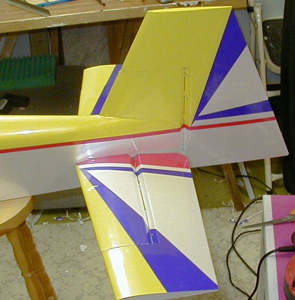

Finished of the tail plane and elevators and this is the end result. Didn't get a chance to do the graphics but they will be next.
Just a little taster of the design and colour scheme so far. The front of the fuz and wings look even better, but you'll have to wait for those.
Thanks for the info about the paint. I might pop to Halfords and pick up a tin, unless you know anywhere better.
Simon
