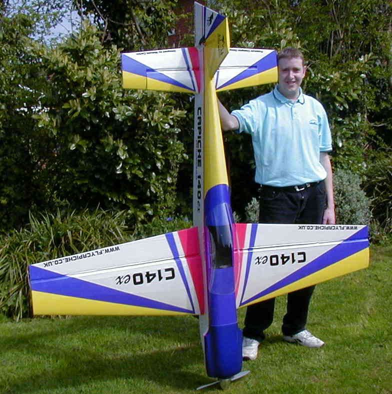

Just a couple of little jobs to do this morning and it's now ALL FINISHED. We're now off flying. Here's a couple of pics of the finished plane. More to follow later. Hope you like it though to be honest we don't really care what you thinkl 'cos we think it's superb.

looks very nice simon. i hope the first flight went well. that colour scheme makes it look huge!

EE, it's not the colour scheme that makes it look huge, it IS huge. Too big to fit in any of our cars, so Simon has to persuade his boss to let him borrow the company minibus to transport it in. The fus is 84 inches spinner to rudder - you try fitting that in a normal car.
First flight was good, a bit of a non event really. She flew really nicely but the maiden was curtailed by the engine sounding a bit sick (Saito 180 not been run for 9 mths) so Simon brought her in for a precautionary landing after only 3 or 4 circuits for a perfect greaser of a landing, really nice and slow. Then we couldn't resolve the engine problem so called it a day. Next flight will be in two weeks time so we'll let you know how she goes then.
I did get most of the flight on video and once I work out how to download it will let you all see it.
Great model though, and her presence ion the air has to be seen to be believed.
Out of interest how many of you have bought one and are actually building at the moment?
Colin

Oops sorry chaps if I've got you all worrying, must have measured it wrong. Just checked it again and the overall length of the fus, spinner to back of rudder is 811/2 inches or 2072mm.
Now that is still a bit over the 2 metres that Zep mentioned, but bearing in mind we're using a Saito 180 and have got the engine sitting a little forward from the firewall, I reckon we could push it back another 10mm, but that'd be about it. The Saito is a rear induction engine and if you're using a front induction engine (what are the YS's I've got no idea) you could save a total of 50mm from the backplate of the engine to the firewall. So you still need to get 22mm from somewhere, or maybe YS's are shorter?? I've got no idea. For measuring purposes, can you take off the spinner? If so that'd do it 'cos our spinner is 32mm from the end of the crankshaft to the tip of the spinner. But that's assuming you can butt the front induction engine right up to the firewall.
It's going to be close. Very close.
If this measurement is important to to you, then I'd suggest you think about it carefully before finishing the model. Maybe chop a bit off the rudder?
Colin
