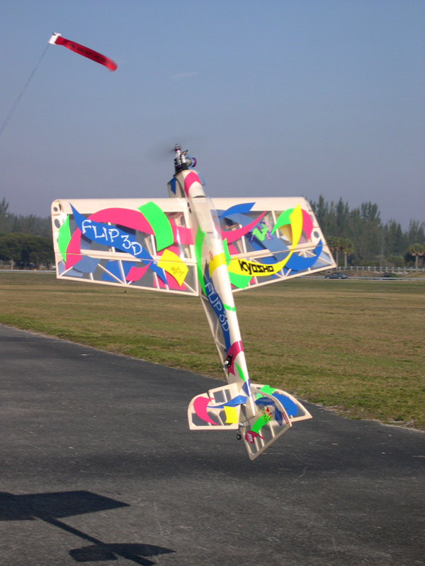

I am wondering what exactly is the advantage of removing the wing tips from the Flip 3D or Hype? I have seen pics and understand the concept but having never flown the clipped wing version, it is hard to understand what it does for you and how it helps these (and I am sure others) performance wise. Is it simply a faster roll rate? do the tips do something in KE flight that is undesireable?
Please help me understand why I want to modify my plane this way.

I find that with out the wingtips the plane rolls faster and knife edges better.

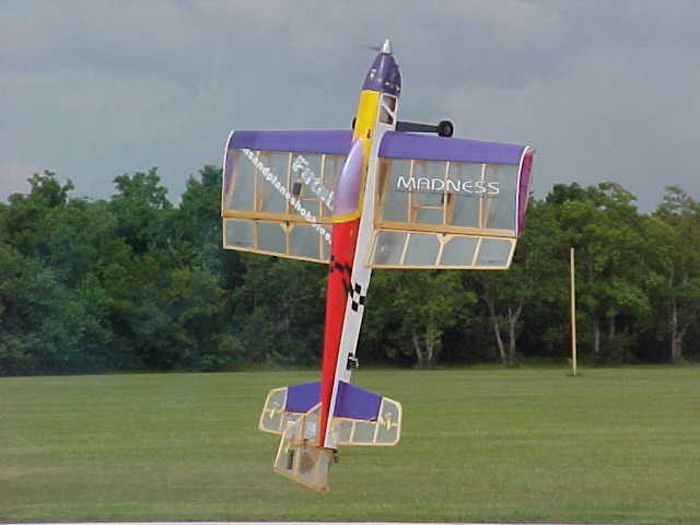

I had a ZN Line Madness that I though flew like crap. Before buring the plane in anger, I decided to cut the wing tips off at the field. And did it make a big difference.

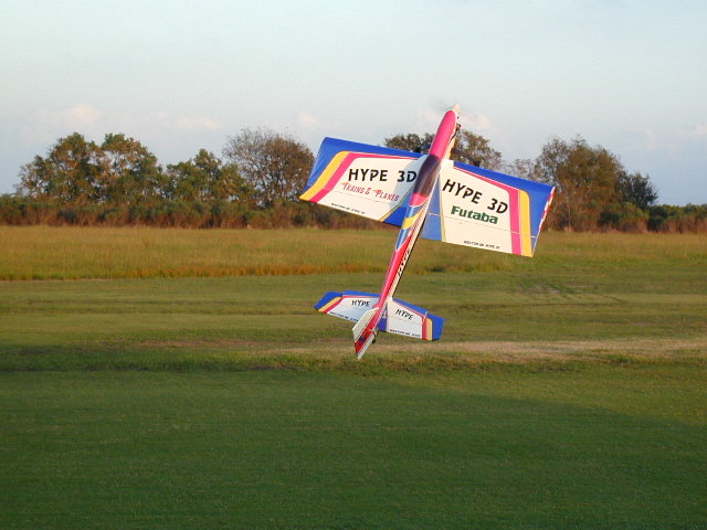

My Hype never made it to the first slight with the tips on, they were cut off during the building process.

It does not take 100% of the coupling out. Most, yes. All, no.
I do not fly with any rudder/aileron/elevator mixing, I just fly the plane.
As far as harrier and elevator's, I really can't say it helps or hurts. I have flown them so much with out the tips, it is difficult to say. I will say this, I found the Flip did harrier and elevator better with spoilerons mixed with the elevator. Don't ask the percentage, casue I don't know.
I will fly the plane, make an ajustment, fly and continue to make balance, thrust, throws, expo, D/R ajustment until I'm happy. This may take 20 flights.
I worked on my Funtana for 27 flights and gave up. Never could get the plane to fly the way I wanted the plane to fly. Took the gear out and now it hangs. One of the reasons I'm not a fan of the Funtana, just could not get it to fly the way I wanted it to fly.
As far as the designers. I understand the Hype designer was quite offended that I removed the wingtips. The designers of the Capshie 50 and 140 changed the wing design of one of the planes wings and took the tips off. I don't remember which one. Something else, I grew up flying profiles and none of the profile have wingtips either. That is where the orignal idea came from.
Tip less does make the plane a little less stable, I admit that. However I look at it this way, I don't want a 3D plane stable. Any experenced pilot flying a 3D performace plane like a Hype of Flip, will not notice the difference.
Removing the tips will not ruin the plane. I am of the other opinon that the tips on hold the aiplane back.
The folks that have taken the chance and removed the tips have all contacted me and told me what a difference it make and we all question why the tips were there in the first place. The tips do look better and I still believe that they make these birds for the general public and in some cases, the plane would be too much for them to handle.

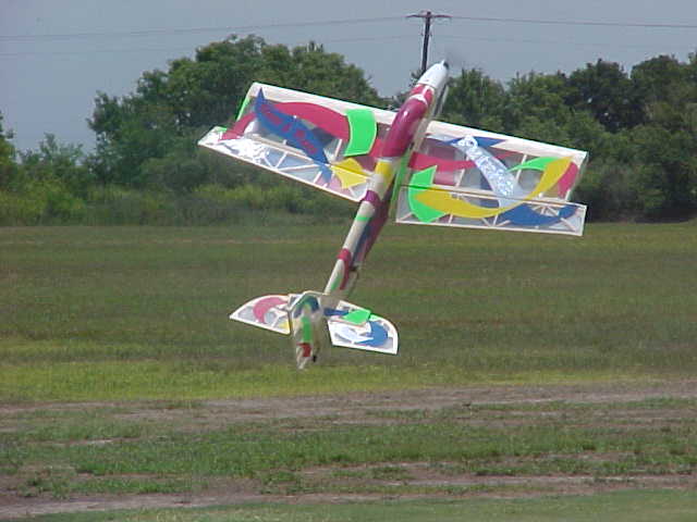

After I clipped my Flip's tips, I notice a few things:
It does roll better at slow speed. Flip's high speed roll is blinding fast, no question about that. But stock wing's low speed roll leaves something to be desired.
It tracks straighter during waterfalls
It will not flat spin for jack. It's much more difficult to do inverted flat spin, and will not maintain long. Maybe it's just my lack of skill. But when it had tips, it will inverted flat spin in a heart beat.
Harrier does seem a little more stable, but still rocks after a while.
Tail heavy landings don't balloon as bad.
Knife-edge spins are easier. I can just fly KE at flying speed, kick in down elevator, and it will start KE spin. Tail heavy KE spins do not require up rudder.
It looks like tipless has more pros than con. But I really miss those flat spins though.

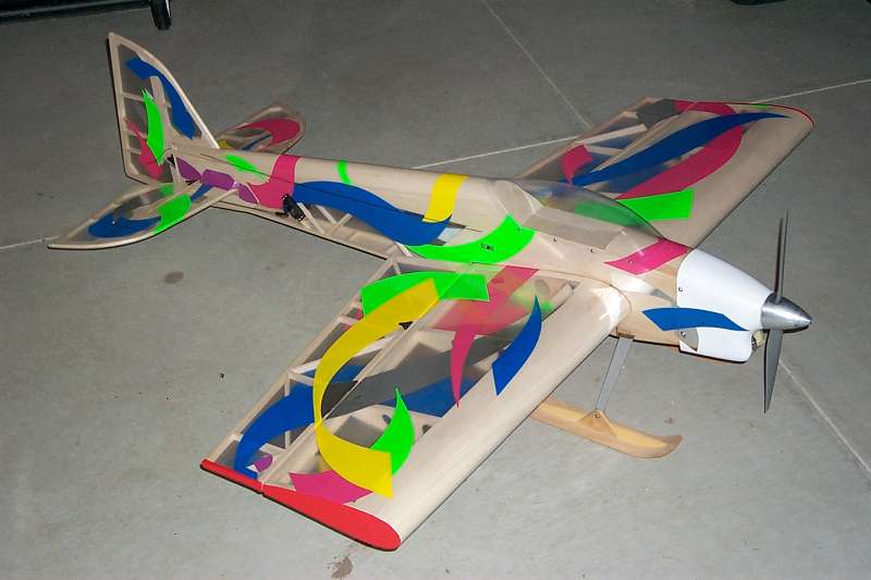

I cut the tips off my first Flip at the Flying field. Xacto knife and clear tape. Since I didn't have the right tools to do the ailerons correctly, I just left the trailing edge and the ailerons as they came. I liked the way it flew, so I just left it that way. Flip 2,3 and 4 were all done the same way.
Great conversation starter at the flying field. At Joe Nall this year, several people thought it was some form of special 3d mod I did. Just couldn't tell them I was just lazy.
My new 3D plane I am designing does not have tips either.
the FF wing prototype i did on the Capiche, i asked about tips, but it was decided to leave them off, i assume for the same reasons you found, there was a 140 with a different tip section, but that didnt work well so it was changed back.
