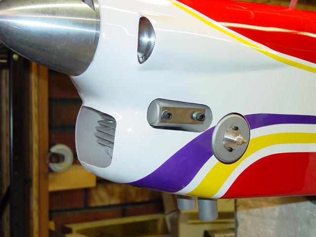

Kasey,
This picture is before I took off the covering. The tubes line up with the carb screws and guide the screwdriver to them. I cut holes in the cowl to match the tubes so I can adjust them with no problem. It took some time but it will pay off in the long run.
Roy

#432
Posts: 68
From: NEW LONDON, OH,
Hi Roy,
That looks like a good idea to me. Apparently that must be similar to what Chip did since he says to use the short standoffs and does'nt mention the spacers like some guys are using. The pictures always help too. Thanks again
Kasey
Kasey

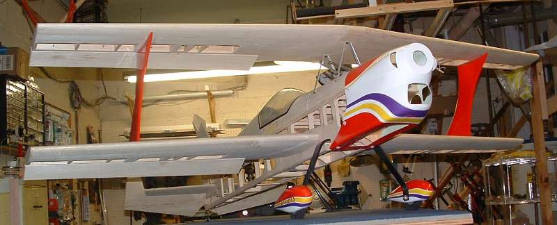

#450
My Feedback: (39)
Posts: 300
From: Candler,
NC
Here is mine all naked. I took some pictures so I can print them off and make photocopies then play with some different color/trim schemes. Thought you all might want to see what's underneath the covering.
Roy
