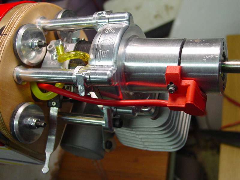

Mark,
The reverse cans that are available will really quieten this plane down. Recessing the can any more will not gain you much. You sort of run into the landing gear plate etc.
You can save much more noise, (if that is not a nonsensical expression?), if you iso-mount the engine. I did it on my Cap 232, Extra 330 and Double vision. The B&B specialties rubber mounts allow you to make a false firewall that absorbs a lot of the vibration that makes the plane into a “drumâ€.
Regards,
Eric.

Old 04-20-2004 | 09:54 AM
  #179
MarkNovack's Avatar
Posts: 1,552
From: Nameche, BELGIUM
Default RE: Its Here!! Double Vision
Thank you Eric. That is an interesting solution for reverberation and I shall take it into serious consideration. If you could take a DB reading with your set-up at 7 meters (Euro standard is 7 meters) I would really like to know what your results are with the Pitts muffler and the soft-mounting. Perhaps it is not as obnoxious as other Pitts muffled systems.
Mark

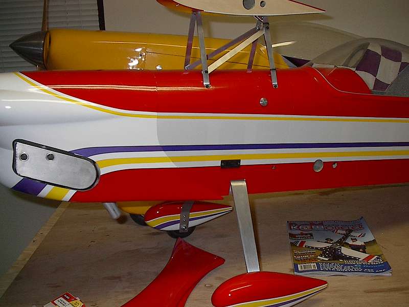

Hey Guys I have been meaning to ask, where did you mount your ignition siwtch on the DV?
Old 04-24-2004 | 09:51 PM
  #190
JackL's Avatar
My Feedback: (7)
Posts: 318
From: Rockport, TX
Here is where I put my switch for the ignition. I'm using a ZDZ50, but it would be the same for a DA. The switch for the radio is in the cutout in the tray under the canopy.[img][/img]

Jack thank you very much for the Pic, exactly what I wanted to see
