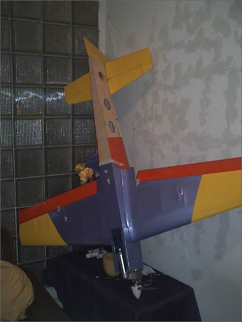

Daniel Z's Avatar
Posts: 490
From: SantiagoReg Metropolitana, Providencia, CHILE
Default RE: 46 FX muffler
hEY ! I have a 60` 5 lb 3D plane that pulls out of hover very well with an os 46fx+tower muffler!!
ID:	113192   Click image for larger version
Old 03-19-2004 | 08:26 PM
pizza's Avatar
My Feedback: (24)
Posts: 380
From: salt lake city, UT,
Hey Daniel Z, that airplane looks like it has a huge side area, and in front of the wing, is that a scratch built? looks like it should weight 8lb but only weighs 5? wow, can we see a picture of it hovering?
