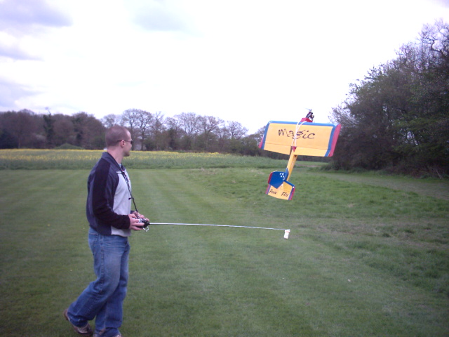

hi guys,just been reading the thread,some good advice and some not so good,heres a photo off my brother prop hanging his magic,i spent the day with him teaching him to prop hang lower than he normally does,the main part was getting the model to back up which can get tricky ,but hes there now.i think these type off aircraft are the best to start your 3d with.

Hey mike thats quite impresive i was watching him getting lower and lower at the weekend! Not so sure people will like the footsteps on the strip lol
See ya at the weekend

hey rc the wind was in that direction and no one was there,the strips ok to walk on,please dont tell the oldys i cant imagine the greif ill get.
yeah see you saturday,goona take me extra down[8D]
