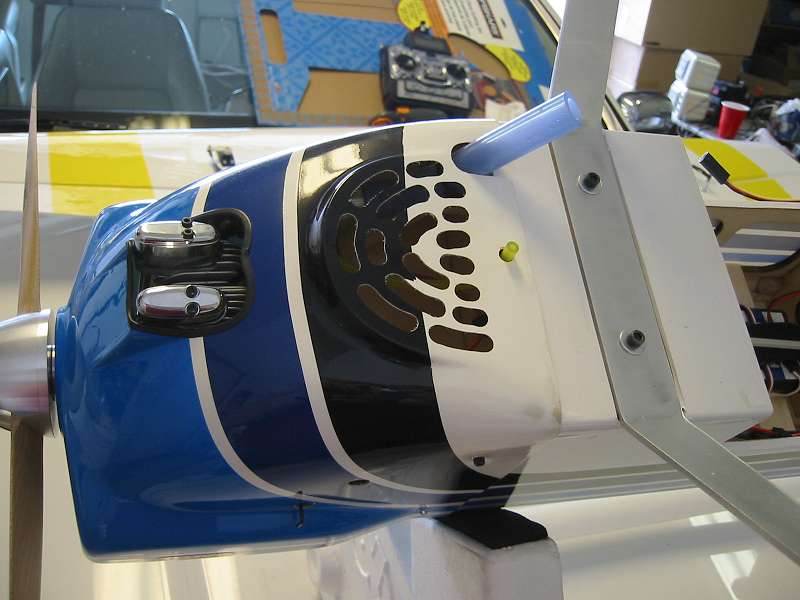

Another CAP Maniac takes to the air!
First, check out the tail feathers bracing... this was just too easy, and solid as a rock. A pull-pull rig thru the fuse and control horns on the h-stab... duh, why didn't we think of this before.
The guts all finished, and the vents cut in the cowl.
Then the flight. Only took it up once, a little windy, but she handles like a dream above 1/4 throttle (Saito 100 running RICH). Smooth rollout and steady climb at 1/3 T, then 3 clicks down and two right, she was straight and level. Dropping throttle below 1/4" she rises and floats, had to push down to get it to land. High idle (2800 r's) was all we could get it down to, so it took all the runway to land it, it just kept floating.
Didn't ring it out, but good pull verticle over 1/2" throttle. Rolls at low rate real snappy, on high rates it is a corkscrew from hell. Stalls into the loop at 1/3 throttle, but perfectly square in and out without any rollout. Slow flight is real stable and easy to manage. Not a hind of tip-stall, even at low speeds. This thing flies easier than the trianer at 1/3 throttle.
Didn't try inverted, but looks like the engine is pitched down a bit, so when you chop throttle is pulls up and floats. More flying to be sure of that. Went verticle WOT once, running a bit too rich still, sluggish but kept going. Easy to handle on the ground, doesn't turn on throttle-up much at all.
She's a keeper, no doubt. With some time to really get the feel for it, I think it will be an awesome flier. What little I did try, it behaved. I think 3D will be good, but I'm no pro, so I'm not too sure. I held a hover up high once for a moment, and it seemed real solid.

Yea Lee, two successful maidens in two consecutive weekends... yehaaa. The Funtana 90 last week, and the CAP this weekend. Sure is nerve racking to take a new bird up. Alas, they are both good ones, no suprises or bad habits. Now we gotta learn to fly these very capable birds like the big boys... the sim is going to get some healthy workout now.
Any thoughts about the float/rise on thottle down? Is it a good assumption about the engine being down-pitched?
Chasrb,
All the tail harware is standard Dubro 4-40 hardware with #6-32 attachment screws. The whole thing only took about two hours to fab and install. It's really tight, and adjustable too. We're really pleased with the clean and neat install. I don't have the packages, so I can't give you the part numbers.
We are 8 lbs 4 oz AUW. CG at 4-1/2. Zinger 14x6 wood. Low rates are pretty soft, with Ailerons and Elevator at about 1" defeltions. We upgraded the elevator servos to Hitec HS-6635's, still have plain HS-425BB everywhere else. Needed the digitals to better syncronize the elevators. Boy, you can really tell the difference in servo quality when you have cheap ones alongside good ones. Speed, smoothness and centering are SOOOO much better on the digitals. We'll upgrade the ailerons and rudder soon too, damn things are so expensive. Wish we had understood this early on, so we wouldn't have wasted money on the cheap ones.
Here is a snapshot on takeoff... totally easy to manage. I am very happy with how well behaved this ship is in the air. With healthy expo (40%) on low rates, anyone can fly it. Flies straight and solid, aileron turns are perfectly self-coordinated without rudder at low speeds. I love this plane. If you can get past all the poor quality hardware and fixing the bad fit on parts, it's a great plane in the air. If we can solve this floating and get the idle down to 2K r's, it will be perfect.
This Saito 100 has not been behaving well, just not broken in yet. We did a little trick a veteran showed us at the feild, where you pull the first coil out a bit on the plug, helped a ton. Before that, couldn't get it to idle smooth below 3200 rpm. It really labors at low idle speeds. We can turn it down to about 2300 now, but it is shaking the plane really bad. Trying to adjust the low-speed screw, but it's just not ready for that. Just impatient I guess, we only have a gallon or so thru it so far. It's running real smooth now at 2600-2800 r's, but it's too fast to sit still on the runway. Makes landing a challenge, it just won't slow down enough. We'll try an APC 14x4W next time out.
