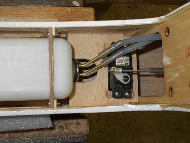

Yes, the bottom is still the stock red and white checks, couldn't give up those visuals. Tank on the CG is the way to go, great improvement. My first three were very intense. This one, #4, is actually a 'frankenstien' built from the first three. I swore it would be the last, but this one wasn't bad enough to discard. Good luck with yours. Joe
BTW, these picks are from when I was running the Saito 100 W/ Cline regulator. The battery is now half way down the tail with the YS 110 up front.

nice work in the fuselage area. did you gain or loose weight?
I have a salvagable wing from my last one. the fuse is hiss. but good tail. I also have a complete hardware box with gear, pants, even the cowl. I guess if i have the time i will make a homebrew fuse. I would like to loose some of the tail length and make the body a little more harrier style and see it it will blender. But first i have to have time

You got me thinking, so I weighed it. 8#11oz. What a fatty. Gained 5 oz. It was 8#2oz. with the Saito 100. Gained 4 oz. with the YS 110 and now the rebuild added 5 oz. With the rebuild came the 'Hatori' header. Not sure what that weighs, but it did displace the muffler and the threaded pipe to secure it. Its all the tails and spare parts that keep me coming back. I have too much stuff to not rebuild. I said it before, but here goes again, this is the last one!!!!! One thing that I did notice with the additional weight from the YS, it flew and handled better. We will see what the gain brings this time. I know that the YS won't notice. Later, Joe

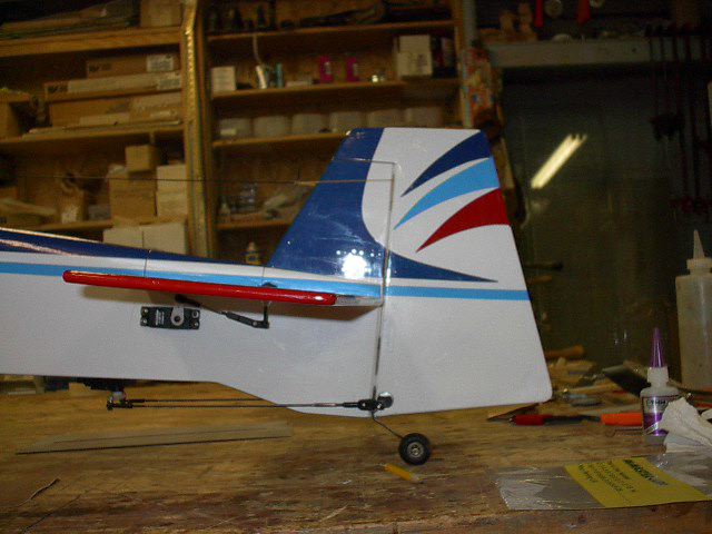

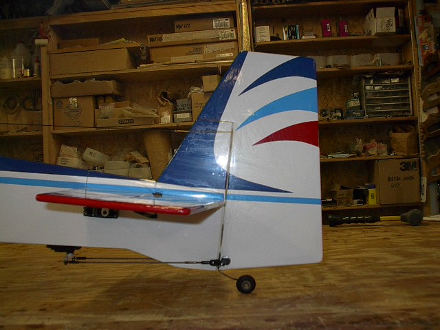

Here is the sequence of rudder mods. First pic is stock, second pic is the first mod, third pic is the second mod and fourth is final. First was a little off the top, Second was removal from the top of the trailing edge, resulting in a tapered effect. The final mod was the addition of some stock to the top, trailing edge which angled the top edge up to the rear. Also the trailing edge received more area at the bottom, enhancing the taper to the back. With the slight additions to the last mod I noticed that less rudder was required for KE. The small amount made a noticeable difference. Again, all this did was stop the way it would drop opposite wing when rudder is applied. It had no effect on the way it dives to the wheels. As some will point out, it could have been done with a radio mix. This is just the way that I chose to approach it.
On harriers you can mix in a little up reflex on the ailerons, slaved to the elevator. I've also read that you can tape two sections of wooden dowel to the top of each wing, about 2 inches back from the leading edge, which, reportedly, ensures that the top of the wing fully stalls by breaking up the air flow. The way that I read it is that the wing rock is due to the wing being caught between lift and stall. Joe
