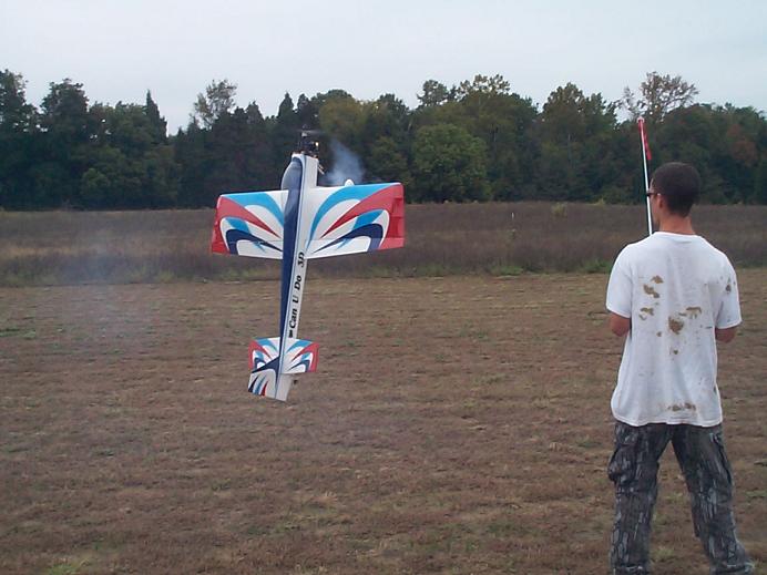

Default U Can Do 3D
saito 120 w/ 16*8 prop. flys great. only mod was moved the rudder servo to bottom and made pull pull, cut the graphics so it says "Can u do 3d" . installed all 4-40 rods on elevators. hovers great. will flat spin kind slow, waterfalls pretty good(use flapperons for trhe best ones) over all flys good but doesn't land as slow as others i seen since it has the bigger motor.
thx
chris

chris,
where is your CG to get it to flat spin? also what technique are you using to get it into the flat? I tried 2 times today but could not get it flat but my CG is at 5" so I'm thinking it might need to move back.
also...mine lands so slow it's amazing. also with the flap mix on at 1/8th throttle I could make it practically hang in the air at a slight nose up attitude. This thing seems impossible to stall practically.

Default U Can Do 3D
my balance is at 5" also right now. the flat spins aren't super flat yet but ahven't experimetned a whole lot yet. i am about full thorttle towards teh end of the spin when it is getting flatter. mine won't slow down that good but i ahve a 16 8 prop, i wish i could get like a 17*4W or 176 but looked at apc's website and it loks like i am about stuff wiht this one. mine doesn't harrier to good, wants to wing rock some. kife edge is good, slight roll coupling. i have got my rudder on pull pull w/ tons of throw, not sure of exact amt but a lot, the elevator is also maxed out. i ahve the ailevators set up but couldn't tell much of a difference tosay also they did make it do a funny flat spin. anyone else using these and how do they help. i am using the new futaba 9caf on it .
thx

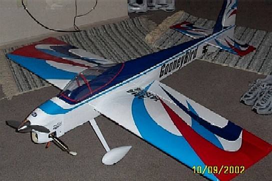

Well, pretty much like everybody, I couldn't stand to put the factory decals on this thing, so when I assembled the plane for the first time, this name came to mind. Check it out. (I know it's not a DC-3!)
