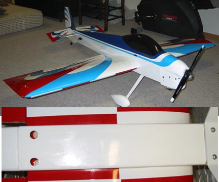

question about the belly pan. mine is about an inch or so too short. if pushed against the former with the wing dowl holes, there is an inch gap in the rear wing former. is this common, or is it just mine??
thanks guys.
tony

i guess i'll have to do that.
thanks for the pic. your plane looks great. i can't wait to finish mine and get it in the air.
i assume the two smaller holes on the right side of your cowl are for the muffler screws?? what size holes did you need to get good access to those bolts??
thanks
tony
