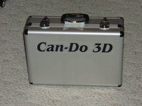

I found a use for the stickers no one will put on their planes. Two of my students at the field today gave me a beautiful gift - a metal case for my transmitter. Better than on the plane....
Rick
Rick
