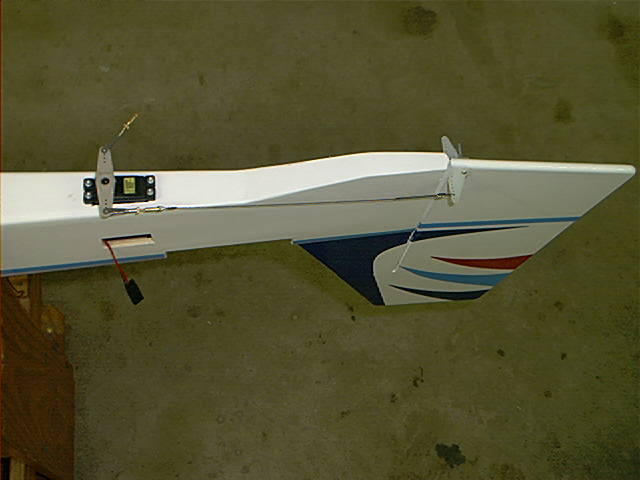

#114
My Feedback: (19)
Posts: 115
From: Kenly,
NC
Here's how I'm doing pull-pull rudder on my UCD. Just cut opening right in front of last former, glue a piece of lite ply to screw to, straight shot to the control horns.
