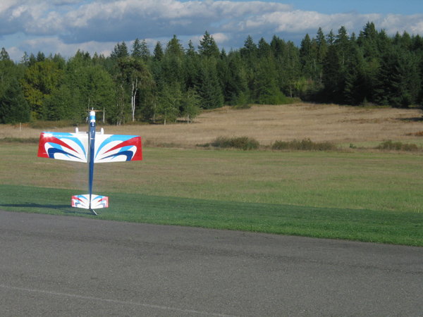

Default U Can Do 3D
mine has a ys 91 and it needs more power, when in a hover it's right on the edge. i don't think a 1.20 would be to much. karl

I aggree with you. I could see it from the get go, that this plane is just to big for a 91 anything. As posted earlier, I put a YS120NC in mine, the tank is moved back to right over CG, the throttle servo and Rx is right in front of trailing edge, battery is in fuse just in front of the single forward servo in tail (I cut a door and taped it shut). I don't know where my CG is right now, but it's not nose heavy any more. I am bringing lead to the field this Saturday, because I like my planes tail heavy, but this plane does need a 120 minimum.

I just ordered the plane with a YS91. The local 3D expert at the field has that combo, and he has pleny of power to pull out of a hover. Are you at high altitude Karl? What prop are you using?

Karl,
What altitude are you at
also what fuel and prop are you running

Default U Can Do 3D
the elevation at the field is about 400', using 20/20 fuel ,15/6apc, i tried a bunch of props this seemed to work the best. the u-can flys out of the hover up but its more like a crawl.i did move the cg 1" back. i think a little more power would be a lot more fun. Karl

Default U Can Do 3D
still very good control in a hover.
