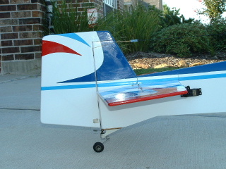

Just ran the engine for the first time with the Iron Bay regulator. I have a Saito 100, fuel tank is on the CG. before the regulator I had the highspeed needle open 1 3/4, Now it's open about 4 turns. Is this normal? Seems to run better, I haven't adjusted the low end yet, it's very close where it was.
Also, for you guys that have the fuel tank on the CG. how many inches is your CG form the leading edge?
one last question, is there anyway to make this thing knife edge nicer?

I've heard that the Knife Edge is improved by shortening the rudder, but I'm not sure about that. Either that, or a ton of mixes in the transmitter....

Definately removing the top of the rudder, down to the fin post, helps take out a lot of the cross coupling

Here is a picture of my rudder
Will removing the top of the rudder completely flush to the fin post be better ? Thx..........

Rajul "Will removing the top of the rudder completely flush to the fin post be better."
Probably, I kept about 1" above for structural integrity and looks. Lowering even further would help even more, I'm sure.
