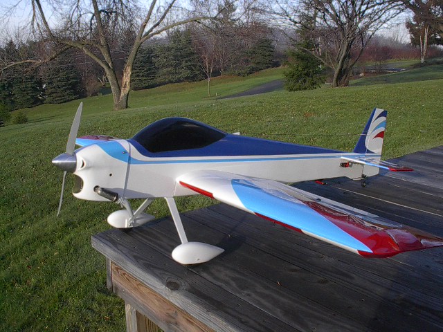

Here is a pic of my UCD. I painted the inside of my canopy with some black paint I got from Lowes. I don't even remember the brand name. I didn't bother doing anything to the inside of the canopy other than cleaning it out with alcohol. The paints been there nearly 1 year and it still looks great. Unfortunately I now have a small dent in the canopy from puttin it on my fieldbox cradle upside down. CAn't seem to pop that out. I used R56 canopy glue and black trim tape to seal the edge.

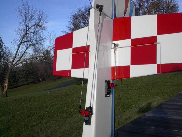

Coo, nice job on the plane. Nice and neat. I see you went with the stock push/pull rudder servo setup. I went for the pull/pull. Does a 7 lb. plane need it? I don't know but would like to think it benefits from this setup. On the cowl I went one step further and carved out those little dobbers on either side of the spinner in hopes of some added ventilation. Looks cool too. Also I took 4 of the brass grometts and rubber mounts from the servos and installed them on the cowl mounting screws for vibration. It helps a lot. Joe

can you explain your linkages a bit better to me? Do you have links to where you got them? I am leaving smaller planes with standard servos now and dont know too much regarding bigger linkages for heavy duty use etc.

Diablo, Dubro carries what you need. 4/40 is the way to go and the UCD.60 can easily handle the wight on the tail. All the stuff is listed as heavy duty and getting packs of a dozen is cheaper than buying individual packs. Here is what you need to shop with the part number:
Quanities are for pull/pull on rudder set up, duel ail. and duel elv.
6 - 4/40 rods threaded one end #144
6 - 4/40 threaded coupler #336 (this gets soldered on to other end of 4/40 rod)
6 - 4/40 ball links #259 (servo arm side)
6 - 4/40 spring steel quick links #304 (control horn side)
4 - Heavy duty control horns #866 (ail. and elv.)
1 - Heavy duty control horn #882 (rudder pull/pull)
Now on the pull/ pull setup from Dubro, The cone that spins on either side is a little long and limits the throw on the rudder. I found shorter CF ones online somewhere. Also you have to bend the threaded rod in the center, like a shallow V shape and angle it forward when installing so the push rods don't bind.
Hope this helps, you are going to love it! Joe

Diablo, If you want to save some money and a little weight you don't really need the threaded coupler #336 or the ball links #259. Just Z bend that end where it connects to the servo arm. The 4/40 hole eats up those little servo arms. Hi Tech has some nice fat ones. I used HS-605BB on ail. and elv. and HS-645MG on rudder. Standard throttle. Joe
