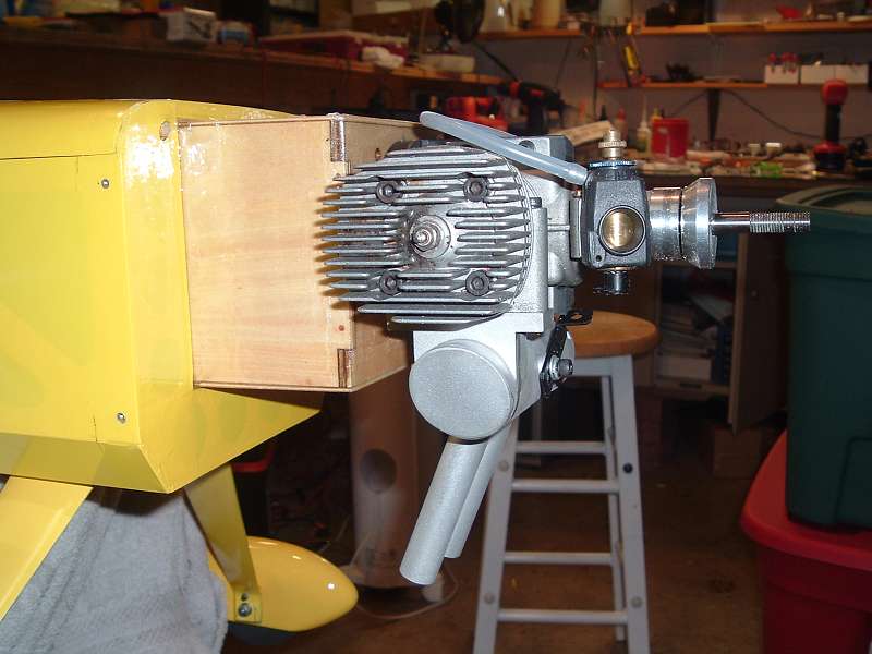

I really don'y know why everyone is thinking that a Saito 100 is to small for this plane. I can understand a larger engine for the high elevation guys but for the most part the Saito 100 is great. On CoolPower 30% Heli mine hovers two clicks past half and pulls out very nicely. It tips the scales at 8 lbs 8 ozs. The key is to get everything as far forward in the plane as you can. I mounted the Rx battery 6.0v 2000 mah, and throttle servo on teh firewall. The Rx is up against the fuel tank. I did use Dubro Super Lite Wheels. They shaved 2.1 oz off. NO PULL PULL on the rudder! It balances right at 7". I also used Hitec HS-475 Karbonite Servos. ( 1.41 oz) This is the best flying plane I have ever flown.

That is Bizzare? You put the battery up front? With that Harley Davidson up there, I would imagine that you will need some tail weight. Mine flys just fine with a .91 OS and 30% Heli. It will hover, and pull out of a Hover. I built it light, and with bare needs, and it weights right at 8 lbs even... You guys put 350 Chevys on the front, you need HP to pull weight. Power=Weight Visa Versa...I love my .91 on 30%.

A Saito 100 only weighs 1.5 oz. more than your OS 91 and will swing the same prop at least 400 RPM more on the same fuel. Mine balances at 7". I highly doubt a Funtana will balance with with an OS 91 without putting your battery up front or adding lead. If you added lead there is no way your plane 8 lbs.

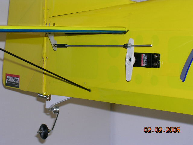

My buddy has a certified shipping scale and it tips his at 8lbs 1 ounce. My non certified bathroom scale shows 8 even. I added no weight, and I put the battery in the middle of the plane, just behind the wing tube to get it to balance at the CG for starters... I used Hitec servos, and a 7 channel Futaba RX. I dont know how you get a heavier engine with nose weight to go the same CG. I guess it doesnt matter, CG it and go with it.. Maybe the models are built with that much variance.

Did you do a Pull Pull?
Old 02-03-2005 | 01:00 AM
Posts: 1,107
From: Chapel Hill, TN
Default RE: Funtana 90 What engine ???????? help
I did not do a Pull Pull. I should post a pic..LOL. I started to do a pull pull, and I put a Dial indicator to the rudder for fun. With a good amount of stress, .003" was all of the play I found. Most of which was in the clevis, not the ball end. The elevator was .005". Not enough for me to justify the Pull / Pull system.My plane is as stock as stock gets and with recommended everything.

I like your tailwheel assembly. What brand and size are your using?
