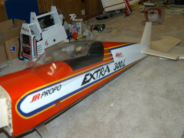

ok, after ages of deciding either to go for the Accel Katana GS40 or save some money for my CA 27% extra, i went w/ the extra. it was bugging my dad that i didn't want to start on it right away and instead wanting another plane so to make him happy i went w/ the extra. i have started one thread in the Giant Scale forum and not much reply, i'm here in the 3D forum asking for help. right now i got $240 and about to spend it all on servos. i'm planing to get...

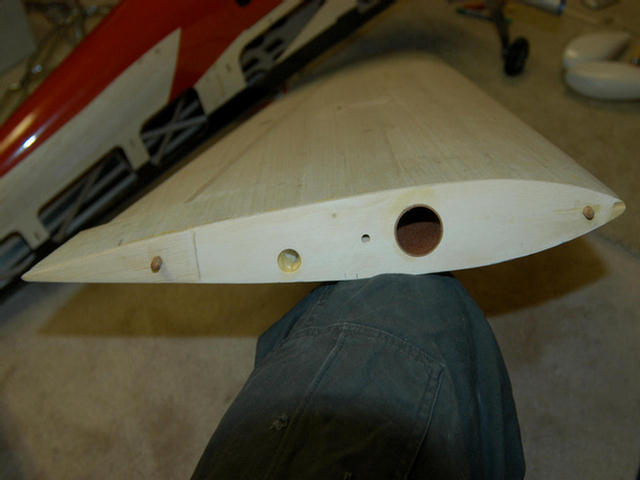

i want to have a bolt go through the wing and the wing tube, but i need help w/ that, i don't know how to do this....

PS. this plane was a trade so i didn't build this plane, i just need to finish it

What you have going from the photos looks really nice. I'm using JR-8411's in mine however the Hitecs mentioned should also work well (at about half the cost). Dowels will work however many have trouble with installation. I use baltic birch plywood 1/4" thick hard-points glued in with Titebond Polyurethane glue. It is really strong and bonds very well with the wood and foam (and also be used to install the dowels previously mentioned). For the wing attachment install a blind nut onto a dowel. Drill a hole into the wing to contacT the phenolic tube but not to penetrate it. Install the dowel with the blind nut against the phenolic tube. After the glue cures (making sure you don't get glue in the blind nut) drill through the dowel and blind nut into the aluminum tube. Use a hex bolt with washer and lock washer to hold everything in place. The bolt tightens into the blind nut and stays in place. As far as the Brison it is good however there have been problems with some of the rings that control the spark advance. I'm running a BME-50 which is about $50.00 more and includes an electronic advance with mufflers (running a Bisson) costing about the same. The BME is a real powerhouse and at only 3 lbs is really great in the power to weight race. BME is an advertiser here on RCU so check them out. I use the Rocket City Hardware (now distributed by Don's Hobby shop and Nelson products) with good results. I make pushrods using a rod-chuck system from welding rods. It is really stiff and cost effective. I made all the pushrods from one 36" rod. Any slop in the linkage can cause flutter with disastrous results. Make sure you use all 4/40 rods and linkages in this size plane. I run redundant batteries and switches into one receiver (JR~PCM only for me in gasoline powered craft). Look at the IMAC forum for photos of planes. Let me know what you like and I'll see what can be done for a trim scheme. Do you plan to keep the current fuselage color scheme? If so then the design should complement it. I have several color scheme files on this plane. If you need one I have a 3 view which when copied can be used with colored markers and the like to test color schemes. See PM for additional information. Make sure the top and bottom have distinctive design differences. Basic geometric shapes are easier to see. Use grey scale opposites for visibility. (Grey scale is evident if you place 2 colors together and make a copy in black/white. White and yellow for the lighter colors with red, green, blue and black as opposites. Take red blue together and they will be about the same scale on a copy machine).

the dowel are preinstalled into the surfaces, and it's diameter is 3/4"... as for the wing attachment, EXCAP232 can you post a few pictures? my mind doesn't work well if i can see it... thanks. the engine i's planning to use is the Brison 3.2, i got a deal of Brison after calling them today, and the guy say if i call back within a week or two, the offer is still open, and it's for $449 for the Brison 3.2, can any other good engine beat that? if so please let me know, i really want to go for a DA 50 or a ZDZ engine, but the price is kinda high. and as for the scheme, i'm sticking w/ the fuse scheme, but after drawing on paper for hundred of time, i gave up not knowing w/ to do. please post some pictures, i would like to see your scheme and pictures of ANY wing attachment method.

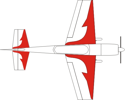

i've been looking around and i found this of Aeroworks.net ... but mine has the yellow stripe, i need a way to blend that into the scheme on the wing. or any other scheme that would go w/ the fuse, please let me know, i got covering at home iching to start but don't know what to do.

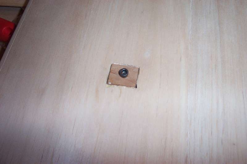

Mount your control horns prior to covering then remove them...They can go all the way through from top to bottom or you can tap the hard point 3/4th the way and thread them in from the bottom..

My hardpoints are tapped and I added some gorrilla glue when I did the final install, once cured overnight I cut the bolt to desired length.

I like what you have. I added an idea in my last post. My idea was to combine the existing color and shapes to complement the existing fuselage. The curves combined with the lightning bolt were the theme followed. You can then add the yellow and blue to correspond with the fuselage (which is what it seems you were going for).
I have attached the design of the bottom of my current plane. The idea came from here on RCU however it was on a profile plane. I actually took a photo of an actual tiger and used the striping to create the cutting file. The orange color is Monokote pearl copper and the yellow is pearl also. The graphics were cut from commercial stock and are holding up well. I would change the eye color from blue if this is repeated on another plane. I like stripes of some sort to keep orientation during sequences. These are very visible on the 84" wing. If I get some actual photos of the plane they can be posted.
EXCAP232

sorry for the late reply, went out camping and wasn't able to answer the post. thanks A LOT for your time EXCAP232, did you have a plan in mind for my design? which one is better the straight or the diagonal scheme?

Xoon,
See the post above I added the first graphic in (white and red scheme). It is the basic idea for your wings. The idea is to use the curves as around the cowl area and the lightning bolt effect onto the turtledeck. Adding the outlines with this as in the fuselage theme. Then add the yellow stripes across the red (as in the fuselage scheme).
EXCAP232

sorry to bother you EXCAP232.. can you draw it out for me? still don't get the fuse outline and stuff... and the yellow strips.. i thanks u a million!

Xoon,
I'll draw it for you if you like the basic idea. I have a carving job to complete this weekend so won't have much time to get much done until after that is complete. I need to scale the plans anyway for another design I'm in the process of doing. That way the actual layout will be accurate.
EXCAP232

I put a Threaded hard point in the wing over the tube, and drilled a hole in one side of the tube, have a bolt that goes into the hole in the wing tube and locks it in place...

how will the nut inside hold to the aluminum wing tube?
so hole in the paper tube through on side, and a hole through the aluminum wing through one side, and a nut inside the aluminum tube? how will the nut hold to the aluminum tube?
