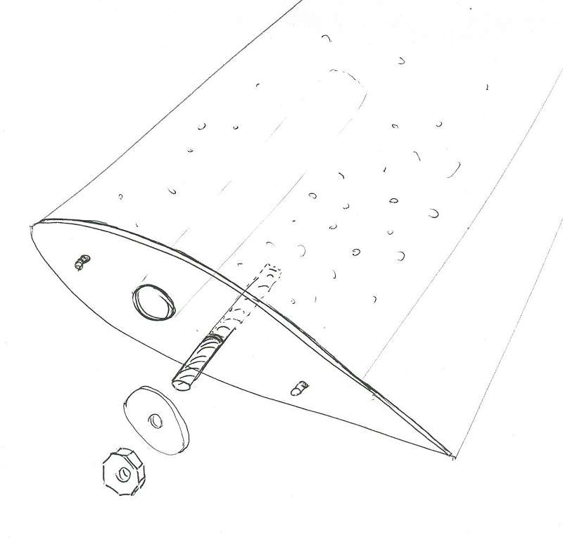

Another really simple method and what I will be using on several planes is to drill a 1/4" diameter hole from the inside of the fuselage into the wing root. Do this AFTER the wing incidence is set. Insert a piece of 1/4~20 nylon "all thread" into the wing and glue in place. You will want to score the portion that is inside the wing to give the glue something to grip. Once the glue is cured you can secure the wing with a nylon washer and nylon wing nut inside the fuselage (Use of nylon thread and nut is so vibration doesn't vibrate loose!). For the 27% one bolt per wing panel should be enough if placed in the center of mass. On larger planes use one near the leading edge and another near the trailing edge. Make sure you won't drill though the wing skin.

so your method would be cutting off the head of the screw and put it in the predrilled hole in the wing root and glue it in w/ epoxy and use a nylon spacer between the fuse and the nut? as for the SETTIN THE WING INCIDENT... i've never heard this before. thanks for bringing it up, what do i do?

With all thread there is no bolt head. It is just a threaded rod. I get mine from Micro_Fasteners in 12" pieces. They also sell the nylon wing nuts and washers. One piece will do your plane. Cut one in half so you have 2 each 6" pieces. Insert about 5" into the wing and allow about an inch inside the fuselage. At the field secure the wing panels with a washer and wing nut.

MY TRANSLATION ISN´T THE BETTER AND I WANT TO BE SURE.......
THE PICTURE IS OK? YOU ONLY FIX THE THREAD WITH SOME EPOXI? BECAUSE THE WING IS ONLY FOAM....

THANKS a lot.. i do a lot better w/ pictures. thanks.. it looks like the method i'm goin to go w/. now w/ the wing incident... excap232 explained it pretty good, but still confused, can anynbody help w/ this? what us the incident for this extra?

Won't be able to get your fingers in the CA to easily for a wing nut so pay attention to the area you do this. Also, if the rib is already attatched with the area cutout from manufacturing then your in business. Just cut a piece of 1/8th light ply to the same size as the lightening hole near the tube. Now carefully cut some of the wing foam away for a 1/4th piece of ply with the wing nut.
Put the wing on the plane mark the outline of the wing. Remove wing. From the exterior drill a 1/4" hole behind the wing tube (leave enough room so a fender washer will clear the wing tube) inline with the tube and rear pin. Now tape that piece of wood into the wing and slip it on the plane, mark through your hole onto the wing root. Remove wing, drill mark and epoxy the 1/4" ply sq with the blind nut to your 1/8th ply back side. When dry slip the piece into place with plenty of epoxy or poly glue, slide the wing on (with waxpaper between fuse and wing) bring wing all the way to fuse till fit tight. Put a little vaseline on a 1/4x20 bolt that is just long enough to go through fuse, wing root and blind nut and screw it into fuse. Secure wing and let dry. When dry remove bolt, wing and tube, clean joint of any unwanted glue. Slide wing back on and check fit. If it is ok then just make a 1" disk or plate to go over fuse hole on inside and redrill for extra strenghth. If not open hole in fuse for a good fit, then glue the disk with a 1/4" hole to the inside to align everything.
Remember this bolt is under mostly tension so it will hold if the glue is set good. I have witnessed the heads popping off a nylon bolt in this fashion from a little bending of the fuse sides so consider this.
A good back up is drilling a 3/32 hole in the rear pin top to bottom and just slipping a cotter pin in to to catch if the bolt breaks or backs out.

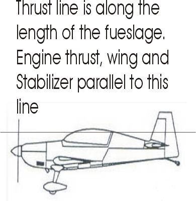

Attaching a drawing with reference lines. The incidence should be 0-0-0 which means the engine, wing and stab should be on parallel lines. There should be no positive or negative incidence to the wing and stab and no up or down thrust in the engine. Since your plane is already built there may be little you could do to change it now. Most likely the way this plane is designed it will not be off much if at all. I have a plane in my hanger that had almost 3 degrees of positive incidence in the stabilizer as received. Even after modifications it doesn't fly well to me. Most observers think it flies really great. Once you have a plane properly set up and trimmed you will understand the difference. You can do some mixing in the transmitter however most settings only work for one speed and angle of attack so as you fly it will change. Let me know if this gives you the information you need.

thanks a lot for the pix... like i said i work better w/ pictures. thanks again. but how do i set this on the extra because it got two dowels sticking out at the end off the wing root and it goes into the fuse, and i can't move it up or down when it is pluged into the fuse. so is this already done for me?

Well set the fuse level. Use the hatch opening to set this up. Check the stab, it should be at 0. Now check the wing bolted to the fuse. It too should be at 0 (both wing halves). If not then what you can do is open up the holes in the fuse for the pins and set the wing to zero. Cut some plywood doublers for the inside of thefuse in the pin area with a hole for the pin and glue them in place with the wing at 0...Before you do this though check and make sure the stab is set to the fuse and not the wing. Then check the firewall is set to the fuse also. If all are 0-0-0 and the fuse is not then keep it there. If not then bring them level with the fuse. If at all possible you want the incidences 0-0-0 to the fuse thrust line.
