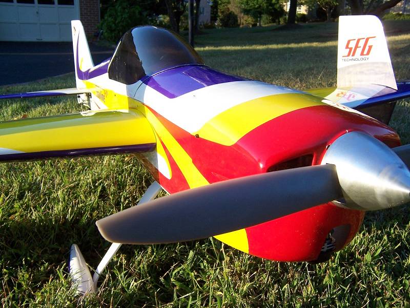

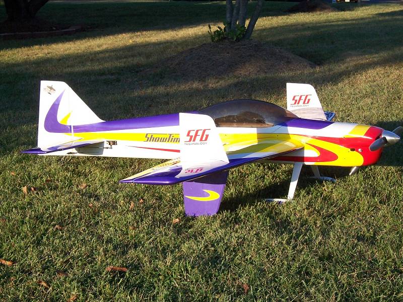

got mine done! Just need to find the canopy screws then take it up!
It has the follwing setup for those interested:
- YS 1.10 with a 90* custom header/elbow and muffler from Perf Spec. I needed this becuase the YS stock muffler would not clear the firewall so this solution seemed the easiest.
- Hitec 5625mg's all the way around and a 5645mg on the rudder in the pull-pull configuration. Futaba 3004 on the throttle.
- Futaba R148DF 8-Channel RX
the YS gave me problems so I did some more research and after some reading tried to lean both the low and high needles out. This seemed to do the trick. I will fire it up again before flight time this weekend to make sure nothing changed.
I also butchered the cowl pretty bad when I was trying to get the stock muffler to work. I will order another one after I get a few flights on it. Also got lots of gluey finger prints on the canopy. Anyone have a solution to cleaning those up?
matt
matt

Diablokid...Great looking build on that Showtime. Your setup is very similar to mine. I hope you like yours as much as I do. Good luck with your maiden. Good luck with that YS, they can be very tricky to set up. I'm just beginning to get mine running good. I found most of my problems were in the regulator. I'm open about 3 turns on the reg. That's about 1/32 above flush. Until I opened that I couldn't get it to idle reliably. It seems rich, but I really don't think it is. I got good top end and it doesn't seem to use a lot of fuel. At my elevation I wanted to lean the regualtor but it didn't seem to work for me. When it seems rich on transition I just open the low speed jet. I run it from 1 1/2 to 2 1/2 open. I have the main at about 1 1/8 open. This is where mine run the most reliable. Good luck on your maiden. Watch out for the dead spot when taking off. Make sure your angle of attack is pretty high.
Enjoy this plane.
Barry
