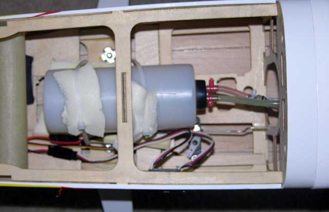

Thanks 7 7/16 it is. By the way do you have a pic of how you installed the tank? And are you using a 5 cell batt

Old 03-05-2007 | 02:42 PM
  #2007
rcfury's Avatar
Joined: Oct 2003
Posts: 968
From: Manassas, VA
Default RE: Showtime
ORIGINAL: JPal101
For my electronics i just constructed some basic holders from Popsicle sticks to mount my reciever, battery, and my MSA-10 for the elevator servos.
My tank is pretty much the same as the electronics but, i just cut out a simple tank mount that is glued into the bottom of the plane, which the tank is just zipped tied in place. I did redesign the tank mount as my other just flexed to much. Under hard maneuvers, some of the glue joints started coming undone.

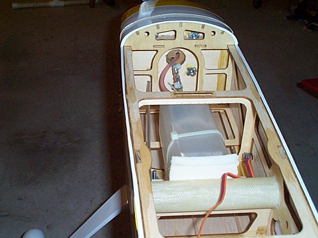

JPal101,
The battery I'm using is a Hobbico HydriMax 6.0V 1650mAh Flat U Sanyo
Not sure if you read the earlier threads... But the above batt. started life in
the ST just in frt. of the tail mounted servos..... So much for the "fingers"
at the wing tip method... Talk about tail heavy.... And at the recomm.
it was where I said, side Frt. of tank, and now it's on the buttom just aft. of
the wing tube... Here's some pics..

Thanks Raideron, I think that is about where I had the first one. Maybe a little more forward just behind the landing gear . I am also going to use a 110, previously I had a Saito 125 but never liked it and had a lot of trouble with it. What prop are you using?
