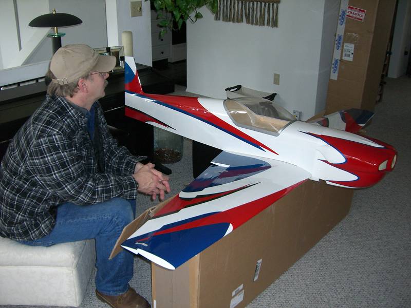

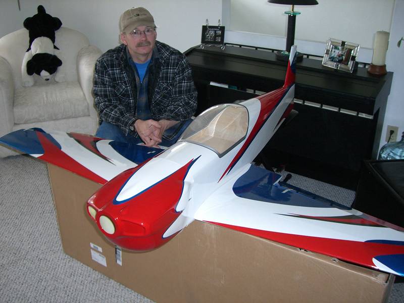

Well my CAP finally arrived and looks great!! A little wrinkling in the wings but nothing a heat gun won't fix. This one should be fun, it's HUGE!!

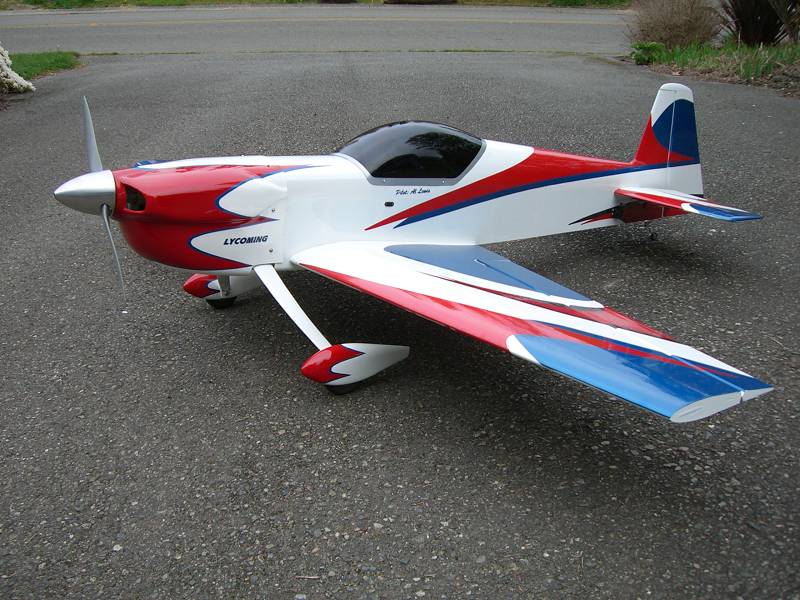

Well I finally got it finished today. About 22 hours total construct time. Plane is a work of art. Really can't wait to get it broke in and in the air. Put in an EDR on-board glow driver so I didn't have to put another hole in the cowl.
