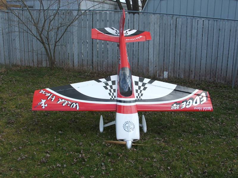

I'll gloat a bit. Here is a pic of the Edge as it is was 8 days ago. I just changed out the main gear to CF as well as the wing tube and prop/spinner. I lost a total of 1.25 pounds making these changes and had to re-balance it. I have not really flown it since because the ignition went south when I took it to the field on an upline. AI is sending me a new one and I should see it today or tomorrow but it's supposed to be rather ugly all week weather wise so it will be a bit until I get to fly it.
The 2 other pics are from Comp-Arf's site since I have not started on them, I do not have pics yet. They are the same planes I was just describing in the same colors

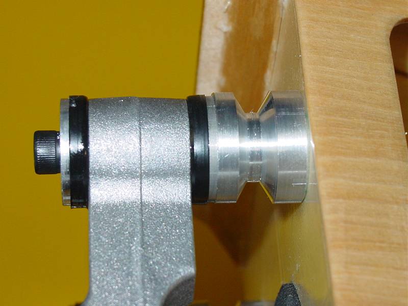

thats a pretty neat engine mount and stand offs where did u pick them up from.?

The mount is a commercially avaiable Dubro Iso-mount. I needed the nose weight and the vibration isolation is a big plus. Made the stand-off's. A plywood spacer block would be just as good.
Same web-site for Dubro mount. See bottom of post.
It says it's for a 1.20 but I have used them over and over again on OS 1.40's and 1.60's with no problems. It is a very solid item. The cast Ali drills and taps well for 6 or 8-32 threads so you don't need nuts etc. to hold the engine in place.
