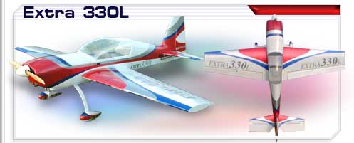

Hey Bubba, you have any first hand experience with the 30% BME Edge or Extra? I'm thinking about building one of the two. From what I can see the hardware and extras are great. Everything is CF and the wing and fuse bags come with the plane. If this one flies as sweet as it looks I may have to add it to the hangar.
http://www.bmeaircraft.com/html/edgeII/extra.html

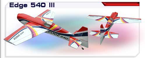

They say that their Edge flies really nice. I'ts a pretty sweet looking plane with a great write-up but they all have that!! I really like the looks of the Extra but like the sound of the Edge's flight capabilities.
http://www.bmeaircraft.com/html/edgeII/edgeII.html
