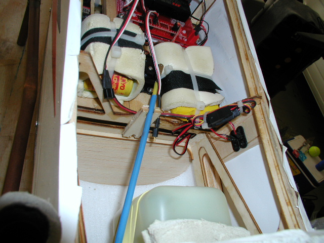

here are some pic of the switches i put in , now i had to repair them always something comming loose , always need to make it better.

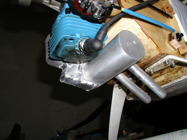

Elvir again . Need some help with my cap with the Fuji 43 ,i put a bission wrap around muffler , with some mods, to make it fit lowering it about an inch . It is quiet now but down on power about 6700 rpm and I think running very hot not an issue with the stock muffler , with a power point 20 x 10 . Could not go vertical at all is the bisson muffler a problem to restrictive for gas flow ? Any thoughts.

I could not tell but do you still have the velocity stack on the carb? If so it is going to be really close to the inside of the cowl and you will need to remove it. I would also be using a 20x8 until the engine is broken in. Mine turned a 20x8 PT model prop at around 7000 so seeing 6700 is actually pretty close
Also, the choice of prop is the other problem which is the power point prop. They are good for stirring paint and that's about all, sorry.
I would suggest just about any other prop short of an APC (way to heavy) so maybe Menz, PT Models, Mezjlik, Bolly, NX, Bambula, Belia, etc.... all in 20x8

I know about the power point prop , my sister came to Croatia a few weeks ago and brought me 6 apc 20 x 10 , i had apc 20 x 8 and had the rpm to 8000 running 98 octane and 100% syn racing oil. i did some thinking at lunch today and thought why is the engine running hot and no performance , only thing i could think of was that the bission wrap around muffler is to close to the back of the cylinder to get any air flow over the fins and getting toooooooooooooooo hot. in the states a apc 20x8 is about 110 for 6 with is about $18 in Austria it is 37 euro witch is 45 to 48 us $ for 1 apc prop,so i fly with what I have left over from the ruff landings if the open field between the sheep , until I get a chance to balance the new apc I got.
