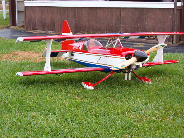

Yep, the elevators are up-side down. I did them correct on the first one and beleive it or not it made no difference in the way it flies. When the first one went it, I left all the same settings in the radio and when I got the second one done All I had to change was a little bit of aileron trim. The 38mm throw is more than enough. All Caps have very powerful elevators due to the location of them. Mine tumbles, snaps, KE's and IMAC sequences just fine on all low rates. You'll find out on the maiden, for the first takeoff, be sure to be on low rates and just ease into the elevator.
One time I was on high rates during the takeoff (forgot to switch to low rates after taxiing out) and I pulled back jsut a touch and stood the plane right up on the tail 10 feet off the ground at about 1/2 throttle (remember this is a DA50). Most other Caps would have snapped, this one just stood right up. I panicked and left off the elevator and planted the throttle and she just powered straight up. I've gotten so used to the power I have, it's quite common for me to jump to full throttle, roll 25 feet and pull straight up. Scale like takeoffs just do not feel right anymore with this plane.
Just make sure your elevators are moving EXACTLY the same all the way through the travel and not just at center and endpoints. If they move differently then this plane, like any other will roll to the side moving faster and you'll think this plane is snappy. I have two spring type clothes pins with long straight sticks of balsa glued to each. I then turn everything on and clip each one to an elevator halve and point them back behind the rudder and make them meet and then move the elevators. Move them slow and then a bit faster. The sticks should remained lined up all the way in both directions. If not look for improper linkage setups, servo arms not parrallel to the hinge line, etc...
ricomari,
My first one had the Fuji 43 and came in at 14lbs even and it flew it well. Remove the velocity stack and use a PT Models 20x* prop and not the APC 20X8 and you'll have a little powerhouse on your hands. My went in because I got stupid with the needles and had it to lean, the very first blender ended in a dead stick and it weas then when I found out just how much this plane floats. I ended up off the runway which promptly removed the whole front of the plane. Number 2 has a DA50 and it's all I could ever want.
Lou55 has some other good suggestions for engines. I'd probably go with the Brillelli. The 40 would be a great choice at 14lbs and the 46 would probably fly it like the Da50 does

I own the Ultimate as well. Most are coming in at 15lbs. Too bad you are not closer. I'd meet up with you and let you have at both of them.
Mine started life on the same 43 that the Cap did and it came in at 16lbs. It flew it but you had no power left over to get yourself out of anything bad. I could do a complete loop if I left it build speed first.
Most everyone is sticking a 50cc engine in that bird and having a blast. Mine has a Brison 3.2 and it's at 15.5lbs and I love it. The Cap and Ultimate are two of my favorite planes. My other is the new WH 33% Edge540 and most likely my next favorite will be the 3 meter Comp-Arf 260 my kids just got me for christmas.
In any case, both planes are big puddy tat's. Here is how I describe the Ultimate.
Big puddy tat on low rates
Big puddy tat with an attitude on high rates
The cool thing is you can switch the rates at anytime on both planes and they will respond instantly. Both are so well setup that if you follow the manual, you will have no problems at all. We have a huge Ultimate thread over here. There is a current concern about one of the wing spars. I have one from the batch that some people are talking about and I have not had any problems with mine. The fix is quite easy and that brings up one more thing. Both the Cap and Ultiamte require very few "fixes" In fact, so far, I have not seen anything on the Cap except for adding some wood at the wing mount saddle to keep it from seperating at the side if you tend to really crank down on the wing bolts.
The Ultimate has a issue on some of them using CA hinges so most everyone is replacing them with pinned hinges. Or than the CA and now 2 planes blowing the top wings off and 3 planes very early on (mine was one of them) having main gear issues, there has been no other problems with it

Here is the Ultimate. My Cap pics are above

Sorry I forgot about the oil.
No need to get the fuji oil. It's very expensive. I used 2 gallons of 32:1 Lawnboy ashless then switch to Penzoil Air Cooled at 50:1. I sold the Fuji to someone at my field. He stuffed it into a GP Yak and still uses the same 50:1 mix and is somewhere around 10 gallons with it and loving it

Those servos are pretty light weight so get everything installed except for the rudder servo, put the plane together and then see how it balances with one servo sitting on the horizontal stabs. That way you will see if you need one or two.
You'll need at least one in the tail to offset the Fuji or just about any gas engine you put on it. If you do decide to go and start learning 3D I'd get rid of those sport servos. They may be a higher torque but they will not handle the stresses of 3D or hard aerobatics.
I'm not saying they are bad, I used them on my showtime doing 3D and they got really sloppy in about 25 flights to the point the elevators were getting really bad. Keep a close eye on them. You can tell when they start to get sloppy. Just grab a surface and wiggle it, you'll feel it.
During the aseembly, you can get away with not installing one of the servo trays (passenger side) which will save about 4 ounces. Just put the battery and receiver on the center mount and the throttle servo on the left side (pilot side) servo mount.
If you look back in the first few pages, there are some fuzzy pics of my internal layout with the DA50 installed

DA50's come with stock 2.5 inch standoffs. Most places where you order the engine from will give you either the 2.5 inch or the 3 inch. Others will charge for the 3 inch standoffs.
You can use either. If you go with the 2.5 inch you will need a 3/4 inch block of wood behind each standoff to get the prop hub out where it needs to be. If you use the 3 inch standoffs, then you will need a 1/4 inch block of wood. In either case, it's important that the wood you use is exactly the same length or you will end up giving the engine some weird thrust anles
I ordered my second one right from DA at the last Toledo show. The first one was bought used on RCU. The standoff's are drilled and threaded for 4mm bolts (I think that's the size) on the engine side and 10/32 bolts on the firewall side. They are not drilled all the way through.
You also want to use nice big flat washers between the firewall and standoffs (car type fender washers work great) to help distrbute the load across the firewall better.
I know your "down under" so I cannot help too much with who can ship for you from the US but the first place I would look would be Troybuilt models (http://troybuiltmodels.com). They give you a choice of 2.5 or 3 inch standoffs

Aussie, the prop and spinner are both from Troy Built Models (TBM) as well. I get most everything from them.
The prop is a 22x8 PT Model and the spinner is a Pete's CF 3.5 inch
If you order from TBM, you can pay the extra to have the spinner cut out and drilled as well as the prop. CF spinners are not drilled or cutout for the prop and they do a wonderful job for jsut a few dollars more and everything will line up perfectly for the DA50
