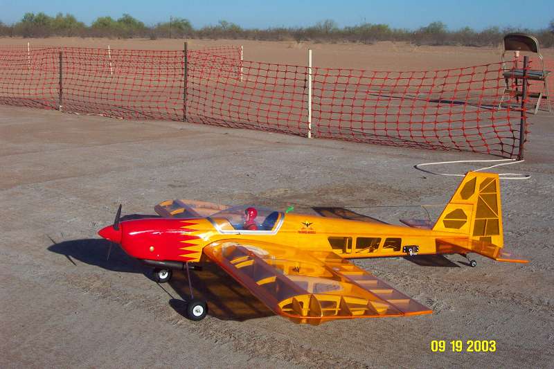

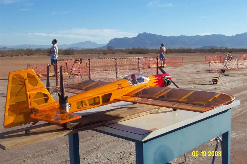

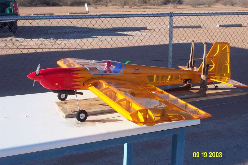

You guys check your hinge pins. Half mine were falling out after the second flight and the rest pulled out easily with my fingernail. This also allowed 2 aileron hinges to work loose. Also the wing dowels were sloppy in the holes. Easy fixes but could be fatal. Still the best bang for the buck anywhere.

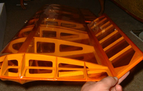

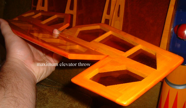

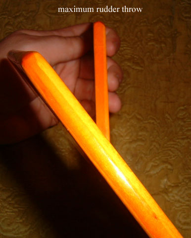

Hey guys,
I just got this plane from Tower today. Overall impression is great plane for the price.
However, I am a little disappointed with the maximum throws in the elevator and rudder. They didn't do the best job with the hinging there; as a result the leading edge of the control surface binds with the trailing edge of the stab when deflected (double beveling would have helped here). Its not bad, I just thought a little more throw should be available on a 3D plane.
The ailerons were hinged much better. They actually dug out a little wood on the leading edge of each aileron so the binding doesn't occur until very large (3D-like) deflections.
I'll try attaching some images to show max throws available on my surfaces. Anyone seeing similar results?
It must just be the "Mass-Produced" situation because mine were perfect (on both the first and second Funstar(s)). The elevators are real responsive though, so you should be ok...

Thanks for the reply.
The rudder was a bit short of 50 mm of throw, as recommended in the manual, so I cut the hinges and re-hinged it myself. The hinges were well glued! I couldn't yank them out, had to slice through them with an Xacto. With new hinges installed, I have plenty of throw. The elevs just barely reach the throws in the manual, so I left them alone. I still wish they had more.
