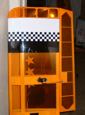

I agree with the difficulty in telling what the plane is doing in the air; here's what I did to the bottom of my wing to help.
Kurt

Cool real close to what I did as well... One pancake will teach you that it needs a little white under the wing. ...............

Yeah i was thinking about recovering the control surfaces diferent colours on each side to make it a bit more ezy on the eyes..
