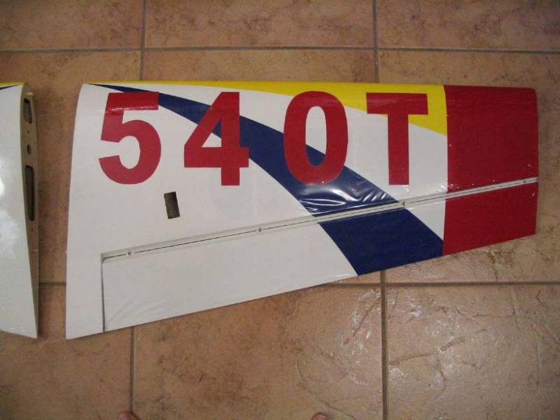

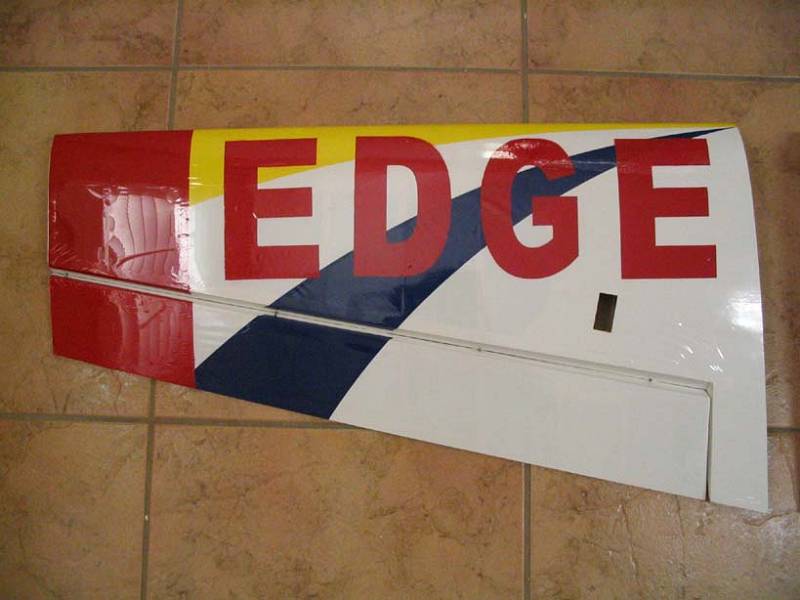

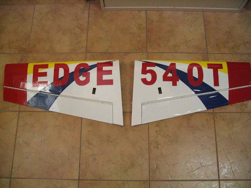

[img][/img][img][/img][img][/img]
Bill33, Here is the red I added to the bottom of the wing to make it easier to differentiate the top from the bottom. The plane is not ready to fly yet but I think this will be easy to see.
