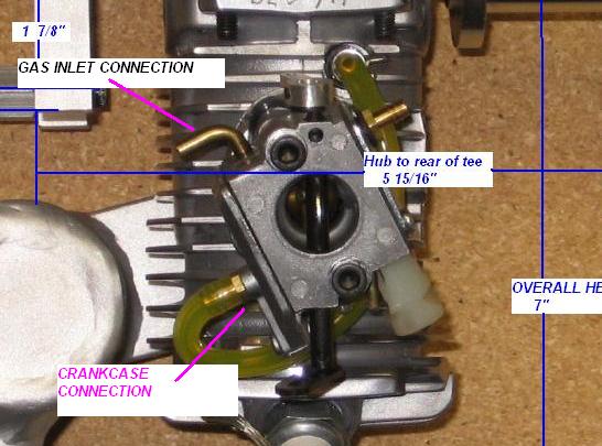

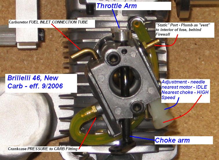

Default RE: Brillelli/Extreme Flight COMBO!!!
Is my carb bad? I just got my 40GT yesterday. Got it all mounted up and plumbed. Filled the tank and no fuel draw . It sounds like there is air leaking out the side of the carb. I pulled the feed line off the carb and tryed to blow through it nothing... I'm stumped
Al
Old 01-25-2007 | 07:35 PM
  #106
Bob Pastorello's Avatar
My Feedback: (198)
Posts: 6,707
From: El Reno, OK
Make sure you are plumbed like THIS picture. You cannot blow through a gas inlet line. Completely different than glow. You would not get a bad carb from him, as he runs everything in place.
Check all your plumbing against this picture.
Plumbing is fine. I did buy this engine from a gentleman. He told me he ran 2 tanks of fuel through it. Funny the only thing that looks used is the spark plug. I guess I will call scott tomorrow and see what is up. This isn't my first gas engine, but I'm no expert with them either. I know something isn't right
Al
Snook, yup did that and checked the needles. When you I turn the prop over it sounds like there is air escaping from the side of the carb.
Al
If it's really new and never been fired, then the carb us going to be bone dry. You need to prime the carb.
Pull both needles out and squirt fuel in the holes. Give it a minute to soak in. Do it again, and then put both needles back in. Screw them all the way in and then back both out 2 turns. Start and tune it from there.
This is the response I got over in the Gas engine fourm. All be damned if that isn't what it was...lol I even woke the wife up, worth it though. The little 40 seems to run good!
