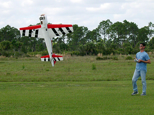

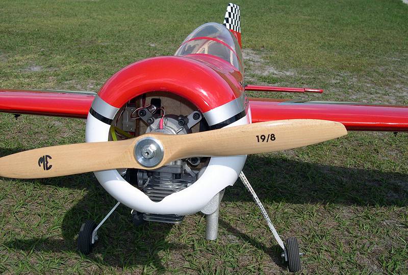

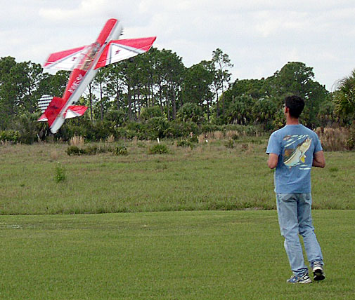

ORIGINAL: STG
It always seems to spoil things when the canopy goes away--Is it OK?
Thanks for the flight report. Sounds promising--like a good combo. Did you get a weight on the plane with the 40 on it? Can you tell much difference with the increased pound or so of weight?
weight with 6oz of fuel onboard 12lbs on the nose
thrust as measured with rapala digital fish scale 16lbs on the nose
RPM 7100 w/3w 19x8
I had to weight it 3 or 4 times and reset the scale each time to make sure it was right. If i recall from memory with the ys160 it 11lbs 4 oz with no gas in it. Here is what i think made a difference. I had to put 4oz of lead on the motor box to balance. I don't need that anymore so i took that off. Smaller tank 18.6oz vs 12oz. Extensions, I moved my rx so i was able to loose 3 extensions. When I weighed it with the ys i had a apc 19x8w and a spinner. Now no spinner and a wood prop. I did gain a ignition box and 1100mah 4 cell battery.
Even though I have less power now the plane seems smoother. With harrier flight before I had some wing rock which could be partly caused by the back and fourth hammering that the YS was doing at idle or just above. The brielli is much smooth down low and it seems to really lock into the harrier now. Anyway another great florida day and I was able to burn more fuel. Here is a few pics.
Al

Yes I ran a apc 19x8w and the 3w 19x8. I settled on the 18x8msc because the spool up was slightly faster

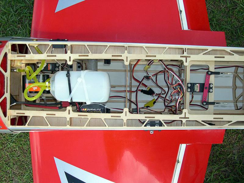

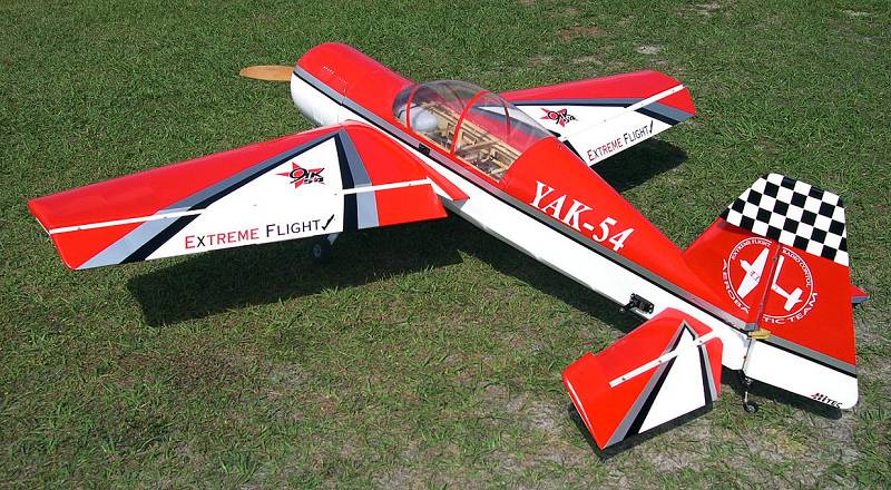

My father and I had a chance to weigh our birds in this weekend. We had 2 Rapala fish scales and 2.5, 5 and 10 pound standards to calibrate the scales. Scales read to 1oz resolution and proved to be within 1oz at 2.5, 5 and 7.5 pounds.
All up weight of both airframes bare minus motor mounts, fuel tank and wheel pants is only 6.5 pounds. OUTSTANDING!!!! To compare it to 2 other planes of this size range that I have done --F90 was 5.7 pounds and Giles UL was 6.3 pounds (no motor mounts, no fuel tank or wheel pants). The F90 is not scale and the Giles UL accomplishes its lightweight with a compromised landing gear design (and does not look scale to me).
It looks like we are on track to have our B46/Yak combos come in very close to 12 pounds with 10oz gas tanks giving us a true take off weight about 12.6 pounds!!!
This weight is based on no spinner or wheel pants and 6oz battery package.
This should be an outstanding Gas package!!!
It is hard to believe that the hobby has come to this point--where you can get a great looking fully capable scale plane that is adequately powered on economical gas & is this affordable and easy to transport!!!
It is a great time to be in this hobby!!!!!
