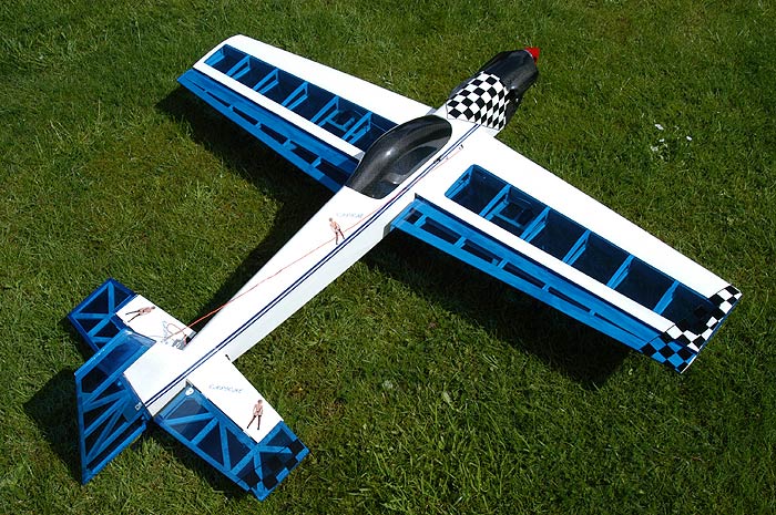

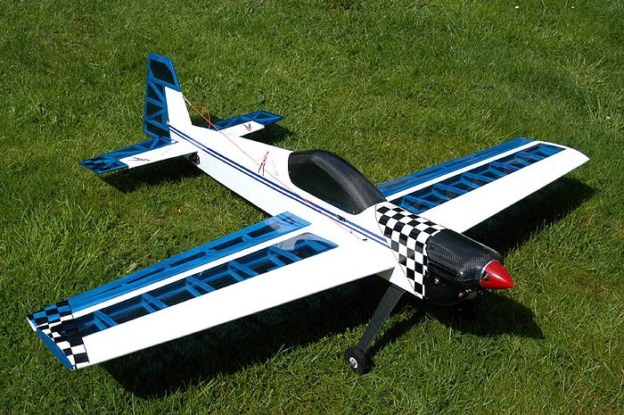

Hi all, I have just finished my capiche after having bought it a year ago at Sandown not much into building rather be flying, but now its ready to go and my CG is 10mm back from the furtherest back position on the plan is that too far back or can it take a little more than shown on the plan? I could fit a bigger battery as I only have 4.8v 900mah at the moment. I have an Irvine 53 up front but elevator and rudder servos at the tail. All carbon cowl, gear and canopy.

Depends on how good a pilot you are!!!!
more than 140 you might need cycle clips
I would start at approx 132mm and go back to taste.

ORIGINAL: Threshold
Welcome to Cloud Capiche Land. For C of G, read the instructions. It is the only model I have built where I was happy in the suggested range. Most manufacturers give a very conservative suggested C of G, but with the C50, the range is bang on. Most of us are in the 125 to 135 mm from the leading edge range.
So any chance of some photos? What about final stats (weight, engine etc).

ok I'm at 138mm so with a slightly bigger battery I'll be 135mm or less so that should be ok to start with, and I won't need those bicycle clips lol, thanks for your help! I'll post a pic as soon as my black spinner arrives and we get some sun. Its dead on 5lbs with an Irvine 53. I am so looking forward to flying it now, after a year of just looking at the plans.

Yes it is a Synergy, OSFX 91 with pump and Genesis mini pipe, 7lbs.
Got some sun for 10 minutes this morning, still waiting for a black spinner and bigger flight battery but otherwise ready to go! looks like waiting till next week for the weather though []
