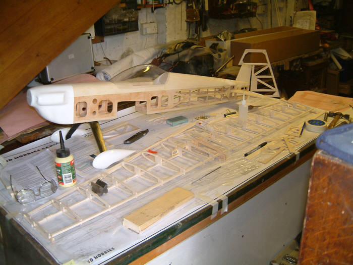

I went solo on it 4 years ago, and i still fly it.Sorry,back on topic , what c of g is everybody using?
heres the building stage dad and i are at .

Posts: 353
From: Bristol, UNITED KINGDOM
Default Capiche 50
the rudder / aileron coupling is there but its slight enough to manually correct it. If anything the rudder / elevator coupling is slightly worse and worth mixing out for KE
C of G - I started in the middle and gradually moved it back until I just need a hint of down when inverted. This gives it good waterfall and KE loop ability, but its still smooth enough for pattern style aeros on low rates.
Chris
