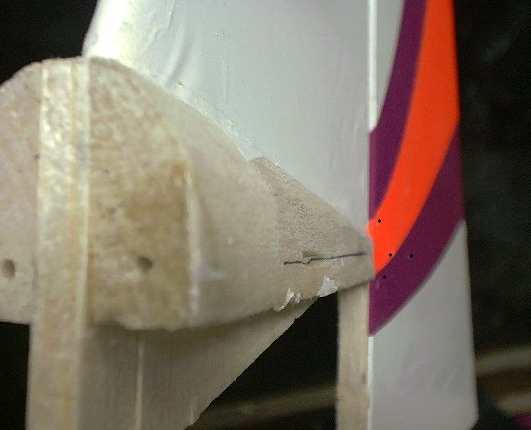

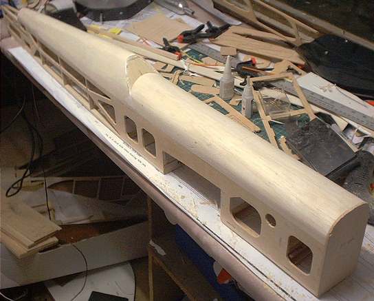

ok, a few pics...
first one spot the diference...
yep, i've not cut out for the canopy, decided to just carry on to get a tiny weeny bit extra strenght seeing as my canopy is blacked out.
second and third, where i've made my pull pull exits inline with the horn and far enough back for clevis, adaptor and movement.

bit confused why you have holes drilled through the soft block?
surely the closed loop can come out lower.. mine does on my 50 e
i think you are too close together... for the geometry to be right you will have a standard - small output arm on the servo

it would come out lower if i had made the horns block lower in the first place, think thats where it is on the plan. maybe it's all the way down, i forget, anyway thats where the holes are, thats where it sits. i will screw out the horns as far as poss, but much more and it'll hit the elevator halfs, no different from the solid pushrod set up from before in that respect
becides, the soft block makes the perfect place to have the guides at a shallow angle, down on the ply that would be alot of wood missing to get a shallow angle, or have to go with a shape angle and have it rub. The blocks arn't effected in anyway by having a hole in them, the fuz might be, just seems the better place to me.
i didn't see any info on the plan for this set up, so i took 20 mins to just think it through, this is what i came up with.
