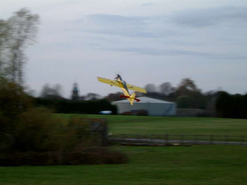

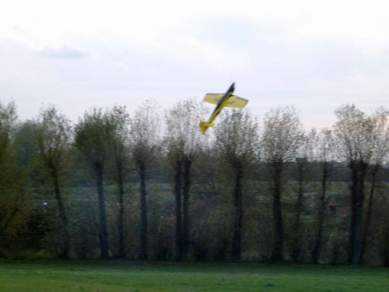

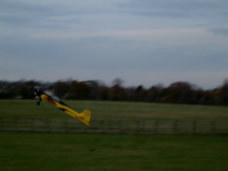

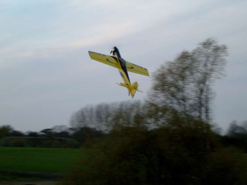

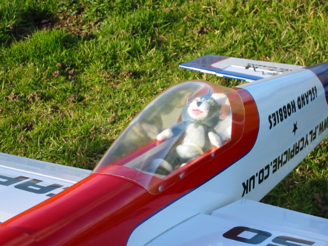

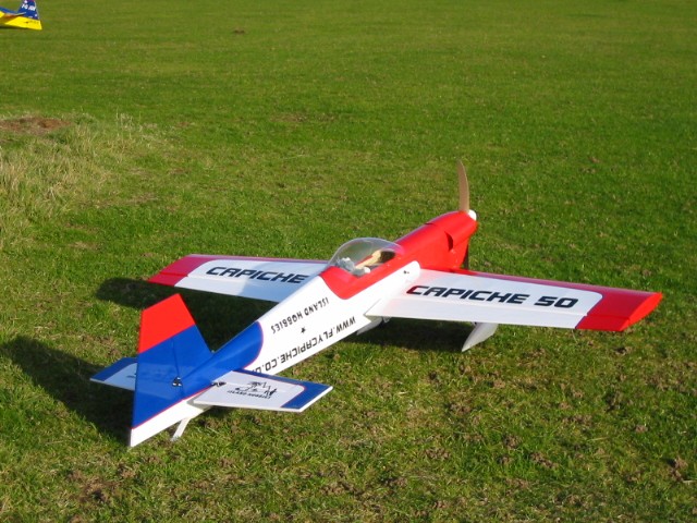

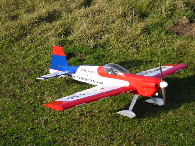

Archie, I have emailed you my photos for the competition and gallery. I assume that I wont win as you dont like my choice in spinner or prop [:@]
I have attached them below for everyone to see.
