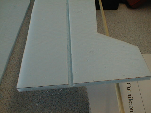

flash18,
Did you cut all the way through the fan-fold for the 3/16" dowels? They're the same thickness.

I set up my dremel and used it as a router.......sweeeet!!! Here is a couple of pictures I took during the cutting.

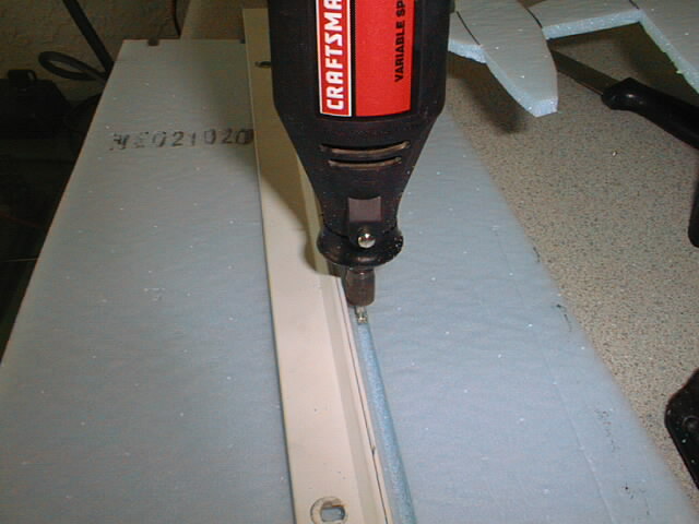

Default Front Yard 3D+Video
Router set up...... I practiced on a couple of scraps, and set the depth to leave a nice tunnel for the dowel.

Looks like an asy way to route the channels. I'll have to try that with my dremmel.

I was real happy with the dremel trick, it made for a nice and straight, clean groove, and suprisingly made hardly any mess. I figured there would be blue dust everywhere in the garage. Do you think a Pitts or Christian Eagle would be a good "fanfold" plane?? I have a 300C, C geared and would like to build for that. I am going to look online for some pictures.. (Pitts) I may have to get some of that "Pink" fanfold..... A blue Pitts????

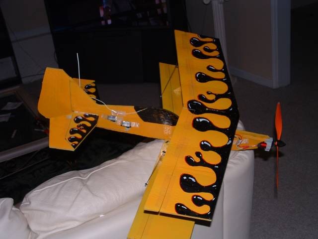

Another UB from a beta build.
flash - looks great! Glad you're having fun!

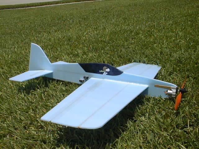

Everything is 1/4 inch FLAT...... I saw a wing maker kit on foamfly.com, it looks like you could make a slow stick style wing, but I don't think it would work with this thickness foam. I am not sure.

That wing maker on foamfly.com is for fan fold and works great. However, not a good application for these planes. The airfoil is just a flat plate. Sounds weird, but works great!

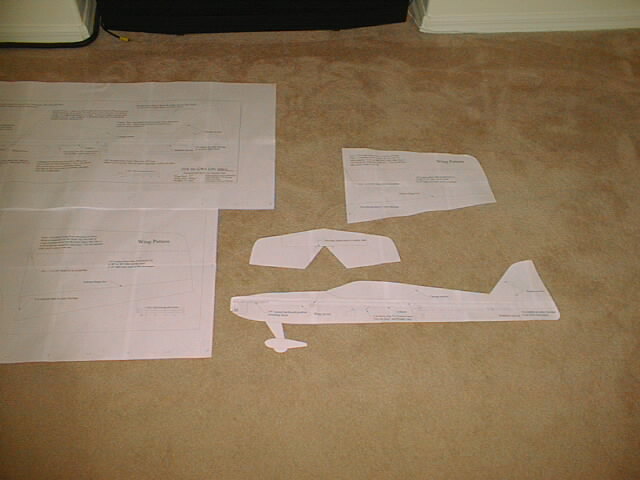

After seeing you have soo much fun with that thing. I went and downloaded the plans last night. I have a couple of questions. How did you cut out your patterns. Did you make a template first? What tool did you use to cut? Razor blade?
Santi
Old 06-03-2003 | 12:42 AM
  #69
flash18's Avatar
Joined: May 2003
Posts: 37
From: Vero Beach, FL
I made up two sets of plans, one set as a master, and one as a template. I cut out the foam with a razor blade on a plywood table. I set up a dremel tool to make a groove for the reinforcement rod, I could not find any carbon fiber rod, so I substituted it with a 3/16 dowel. I started out with 5 minute epoxy and found a hot glue gun to work much better, using the low temp setting. I had my first flight with it saturday morning and had only flown Slowstick, E-Starter, and Duskstick before. It is a blast to fly, I just need to get flights longer than 6-8 minutes to get comfortable with what it can do.
