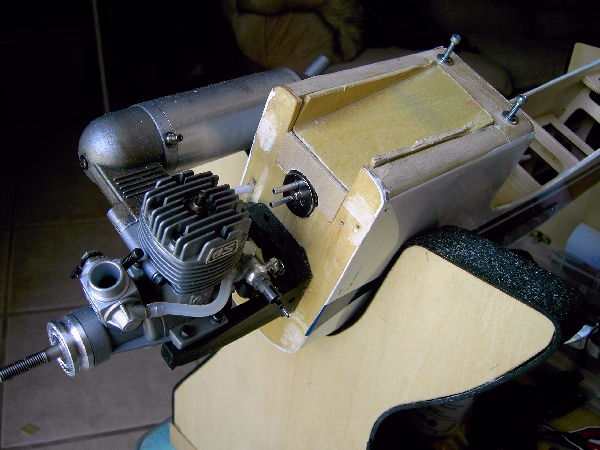

This is my tank mod hope it helps some others. Lowered it to carb level. The glue is drying now. I did go back in and reinforce it. Hope it works good.

Guys... question...
My OS 70 II will not hover my U-Can.
Right now I'm on Cool Power 15% with an APC 14x4w. I'm running the Uni-Flow tank setup and it works like a dream. I have my CG at 6 1/2 " (yeah... I'm crazy). No tach, but I'm running audibly rich. No scale, but I built lightly, and this is my 15th plane or so, and my first ARF so I know what I'm doing.
I'm going to do some needle tinkering today to see if it helps.
I know I'm not going to get .91 Saito performance, but the .70 should AT LEAST hover the damn thing.
In a slight (and I mean SLIGHT) breeze I can back it up in a harrier, but as soon as the nose goes up I start to lose performance. I would think it was a leaning out problem, but the engine note never changes, the plane just tailslides and falls. I know my idle needle needs to be leaned out, but my high speed is where I always set it up.
Here's my question: I have seen and heard of people running the 30% heli fuel in their Saitos, but how well does it work with an OS? I was told at the LHS by a man who is far older and wiser than me that OS engines can get a little cranky above 20%. Anyone out there running 20+% in an OS 70 that can give me some feedback? I think the 30% would give me the power I need.
Setup:
U-Can 46
OS .70 II Surpass
APC 14x4w
Cool Power 15%
3100 mah Rx pack
Voltwatch
Field @ 750' ASL

Have you tryed a smaller prop 14x4 seems big for an os 70 13x6. might be better Also that 3000 battery might be pritty heavy to.

I agree. Too much prop. Maybe even a 13x4W. And 30% Nitro will help a lot. Also, dump the battery for one 2 ounces lighter.

Hello, this is my first post but I have been reading here for a while. I had a os 70 in my ucan and it does hover and will slowly pull out. I was running on 15% on a apc 14x4w, turned this prop fine up around 10k. I have since had a need for more power and got a saito 100 . Its still running a little rich but it seems to vibrate way more then the os did, do they all do this? But the power is unreal, hovers at half throttle and pulls out like a rocket.
