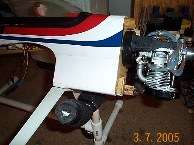

perkinsm, On my used UCD46, The person I got it from also
ripped out the landing gear block and just re-glued it.. When I
got the plane one of the landing blind nuts was loose.. So I cut
an opening on the side(see pic) to gain access and just
recovered with some white patch sticky covering, it's close but
slightly off in color.. Anyway since I had access I went ahead
and and added some triangle bulsa stock to the block on the
wing end.. I also added some lite ply at the front of the landing
block up along both sides... along with adding more epoxy...
On the side of the fuse there is lite ply to help strengthen the
sheeting... I luckly cut my opening between these strips:-)
Anyway my cut was as such... 1&1/4" in from the firewall,
1&3/8" from the wing opening, 5/8" from bottom of the fuse,
and another 2" from the bottom of the fuse.. I know I would
hate to make hole in a new plane... But..... You can make it
unseen if you take your time.. I'm not sure if you have to trim
off some covering off of the wing to glue the bottom pan, but
if so that would be enough to cover the hole in the fuse.. after
saving and than re-using your cut out piece from the firewall
area... When I re-glued mine back in I just glued some bulsa
strips inside the fuse as a backing to help hold the replaced
sheeting... Anyway hope this helps... Not sure if it's needed
but the previous owner also added wires to the hor. stab....

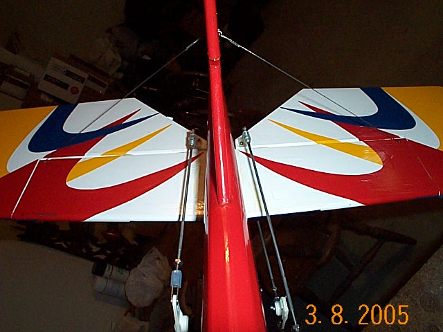

does any body have any pics of the tail wires that they have put on? Have two new projects to get underway! A kangke Monocoupe 1/5 scale and a 25% Kangke cap 232 120! I checked the landing gear on my U can do today, it looked strong, but I think that I am going to do what perkinsm did. Looks great. I have some 18 gauge aluminum that I think I will make the brace out of. Going out flying in the morning. Finally have the Magnum broke in! Time to start leaning it some.

Hey goldenclan, The person I bought my UCD from said he just use
a small fishing swivel and C.A.ed it in the vert stab. then drilled the
holes in the hori. stab and inserted a little brass tube he had and
C.A.ed that in, then he drilled three holes in a light piece of medal
he had which he screwed to the bottom of the fuse... Not the best,
but he said it was free and it works:-) hope you can see the pics..

Goldenclan - You actually have a better idea, using aluminum. Flying in the Morning !!! Wish I was, it's 17, windy and snowing here in West Virginia [

Thanks for the pics! It will help out alot. I will make a few of these braces, and will post a pick of it. Then if any one wants one, let me know and I'll make a few more and mail them to who ever wants them.

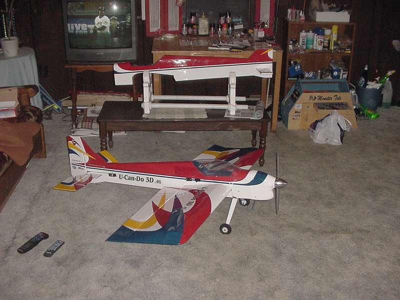

[b]Looks great Raideron,, here's mine. New one, still being put together, and one that has somewhere around 100 flights......Saito 72 W/ 14X4W APC..[/b
