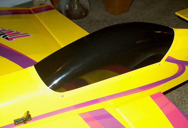

Northwing...Tinting your own canopy is a challenge. It's not normally something one ought to try at home. Same kind of deal as sewing your own props. Not recommended. But if you really want to do it...Take a carefully made mixture of paint. I noramally use black, but sometimes silver, red or whatever. Then will no preperation whatsoever...I paint the canopy. If you paint it on the outside it looks like crap. So......I paint it on the inside. Runs don't matter, use can use a brush or broom or your finger. Anything works. I've even done it with an old rag. Just apply the paint. When you look at it from the outside it looks like a professional did it. If I use a light color like silver or red or light blue, I'll apply the base color and then spray a darker color (black) over it. It gives it even more depth. Pretty cool.
The other thing I like about painted canopy is you can hide stuff under there!?!?!??!!?

ORIGINAL: Northwing
Barry how did u tint that canopy?. Looks great.

Your canopy looked transparent in the photo. I thought you tinted it. I have tinted canopys many years ago (1960s) by putting Rit dye in warm water and letting the canopy sit overnite. The problem with that is there is a fine point on how hot or warm you make the water. Too cold and it won't tint no matter how long the canopy sits in the water. Too hot and the canopy warps. I have ruined many canopys trying this. Once in a while it comes out just right. I thought you had a more sure way to success. I have painted the inside of canopys for years. Your right, they do come out looking good. Even if your not a good painter.

Northwing...If you want to just tint the canopy...There is a paint for that. I got mine from Tower Hobbies. You paint it just like you would regular paint only when it dries you can see through it. I've done a couple of my planes that way. Easy to do. The paint is called "windshield tint" and it comes in a spray can. Pretty slick the way it works.Thanks

Northwing...I just looked on the Tower website. The stuff I use is made by Pactra. Their part # is LXCY44. Sells for $4.29 a can. I've used that stuff. It works good. You just keep adding coats until it's the darkness you want. Easy and quick. Be sure and paint on the inside.

Barry,
I use the Pactra too, I noticed you need to let it dry thoroughly, it gets darker fast. I spent countless hours detailing the cockpit of my G202, then tinted the canopy til you can barely see through it.....haven't had the time to order a new canopy.
