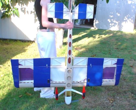

Finally seeing the light at the end of the tunnel. I should have it flying right as the weather starts cooling down. heres a few pics, let me know what you guys think.
Dylan

last one. the purple on the rudder isnt permanant at the moment, im thinking of doing a red and purple stripe on the rudder to match the rest of it, keeping it simple is moot at this point..
Dylan
