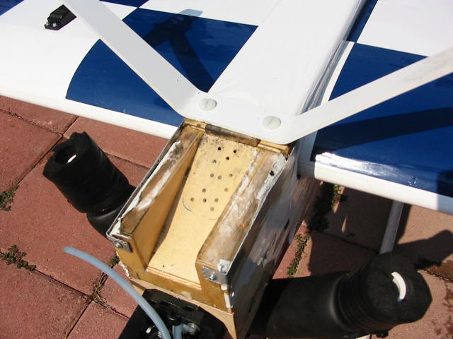

Old 10-05-2003 | 01:55 PM
  #522
Joined: Aug 2003
Posts: 118
From: Stuttgart, AR
Default RE: U-Can-Do 3d 46?
The landing gear will fold right under the very fragile wings
Thats funny. I'm the guy that put nylon bolts in the landing gear. My plane may look like crap, but I'm still flying with an intact wing and stab. I do not use the wheel pants though. Ever since I placed the nylong bolts in, I have ripped my landing gear out about 3 times now and haven't damaged anything (except the firewall the other day). I placed a saito 91 on front the other day. On the second flight after the maiden one, the motor died at take off. Was about 10 feet off the ground going into strong head wind. The plane just acutally stopped in mid air after the motor died. It came down and I almost had the plane pulled out but it hit kinda hard on the gear. The gear went out perfectly, but the big saito heads drug the ground and pulled the firewall out. Since then, I have remounted the motor right side up and flew all day yesterday...... without no problems!

Old 10-05-2003 | 02:05 PM
  #523
My Feedback: (21)
Joined: Mar 2003
Posts: 9,227
From: Manhattan, NY
ORIGINAL: Capt_Kc
Well ... Try the nylon bolts with wheel pants and see what happens. Then get back to me. I still believe in re-enforcing the situation rather then taking the easy way out.
