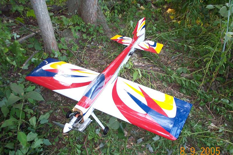

Looks pretty godd back on the ground.

Hey Sctcrash, Good job in getting it back. It looks great. In fact, it looks better than my plane. Hmmm.....[:-]
