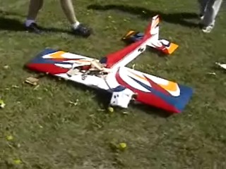

I will need a new U can do, that plane is just too much fun. After flying that plane for 10 months, yesterday I made a mistake to close to the ground, instead of pulling inverted I try to loop back up! Didn't work too good! But fortunately Traci was to get that on video.
If you want, you can enjoy the clip on youtube!

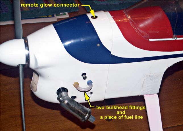

This is the setup on my well used UCD 46. It once had a Sullivan fueler but this is more reliable.

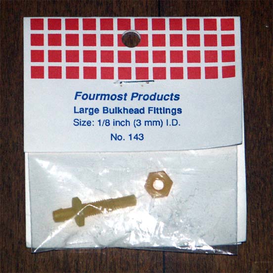

I buy those Fourmost bulkhead fittings at my local hobby shop but Tower also stocks them http://www2.towerhobbies.com/cgi-bin...G851&P=SM#tech .
They come two in a package, a yellow and a blue one (See picture, I've already used the blue one).
By the way, I back them up on the inner side of the cowl with a small thin (1 /32) piece of plywood. That may not be necessary but I didn't want to worry about the flexibility of the cowl.

where does the feul come out when its done feuling up?
Old 06-04-2007, 09:17 AM
  #6016
Rocketman_
Rocketman_'s Avatar
Join Date: Oct 2003
Location: , MA
Posts: 1,270
Default RE: U-Can-Do 3d 46?
It comes out of the tank pressure line at the muffler.

so one fuel line connects to one of the part and the other piece and the feul line thats out side of the coweling is were you fuel up and when your done the gas come out of the muffler right.
Old 06-04-2007, 01:12 PM
  #6018
Rocketman_
Rocketman_'s Avatar
Join Date: Oct 2003
Location: , MA
Posts: 1,270
Yes it will come out of the muffler if you fail to disconnect the line from the muffler. It is intended that you disconnect the pressure line from the nipple on the muffler while you are filling the tank.
