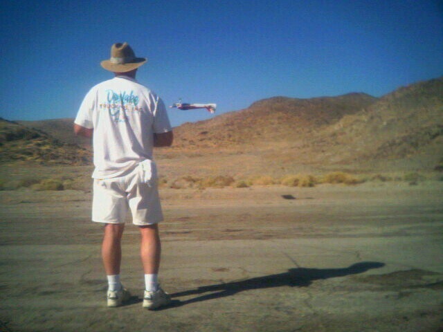

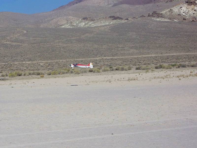

always great to have a day like that. i just moved to Nevada and had a hard time finding a good place to fly but i finally came up with one on advice of an oldtimer that has lived here awhile.
ID:	764911   Click image for larger version
ID:	764912   Click image for larger version
ID:	764913   Click image for larger version

That looks great Gary. Not much to hit in a dry lake bed and everywhere I have been in Nevada there were plenty of them to go around. There is a problem with your slow and low UCD pic though......the plane is right side up?!? What gives??
