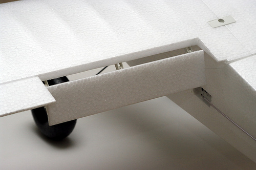

I ordered one - after seeing an example last week at the park
It is called FunCub by Multiplex and available from various sales groups - Mine is from Horizon Hobby
very scale - very light- under 10 oz ft wing loading at 590 sq inches! first pic is full scale- last pic is model
The workmanship and design on these tough foam models is exceptional -even the wheels and tires are made from the stuff. Iwill use the glider program for Radian -in my DX8 tx thisprovides adjustable flaps and or flapperons OR crow or reflex in ailerons and flaps
