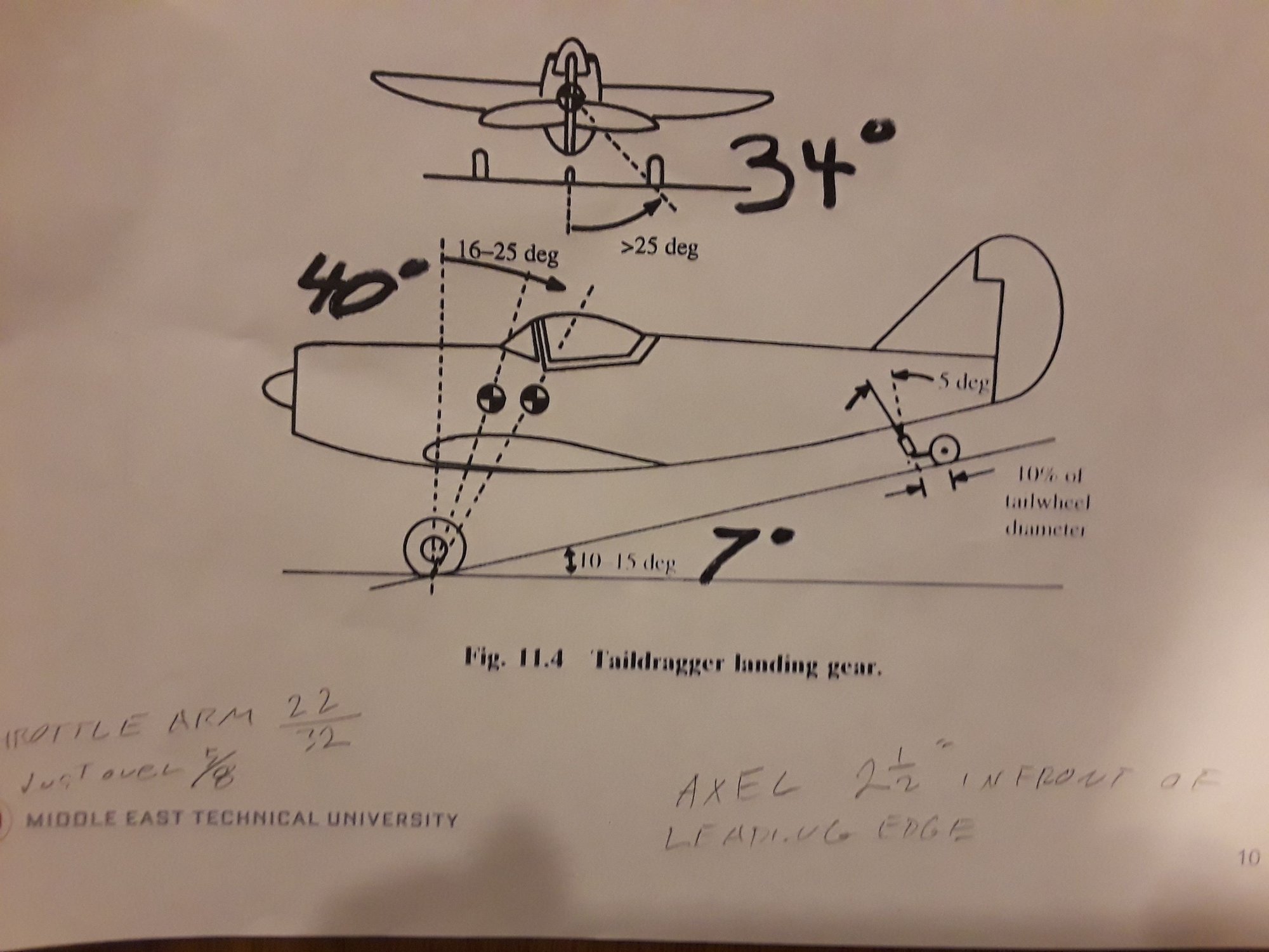

Default landing gear pdf
The professor shows the landing gear behind the leading edge of the wing . It will be possible to measure the angle from CG to axel. The question that will be hard to answer is where is the CG vertically. Based of the location of the battlers and balancing weight a good guess is about one third of the distance from the bottom of the wing to the top of the fuselage. Today has been a beautiful outdoor day filled with all of the activities it takes to care for 3 acres of plants and grass.

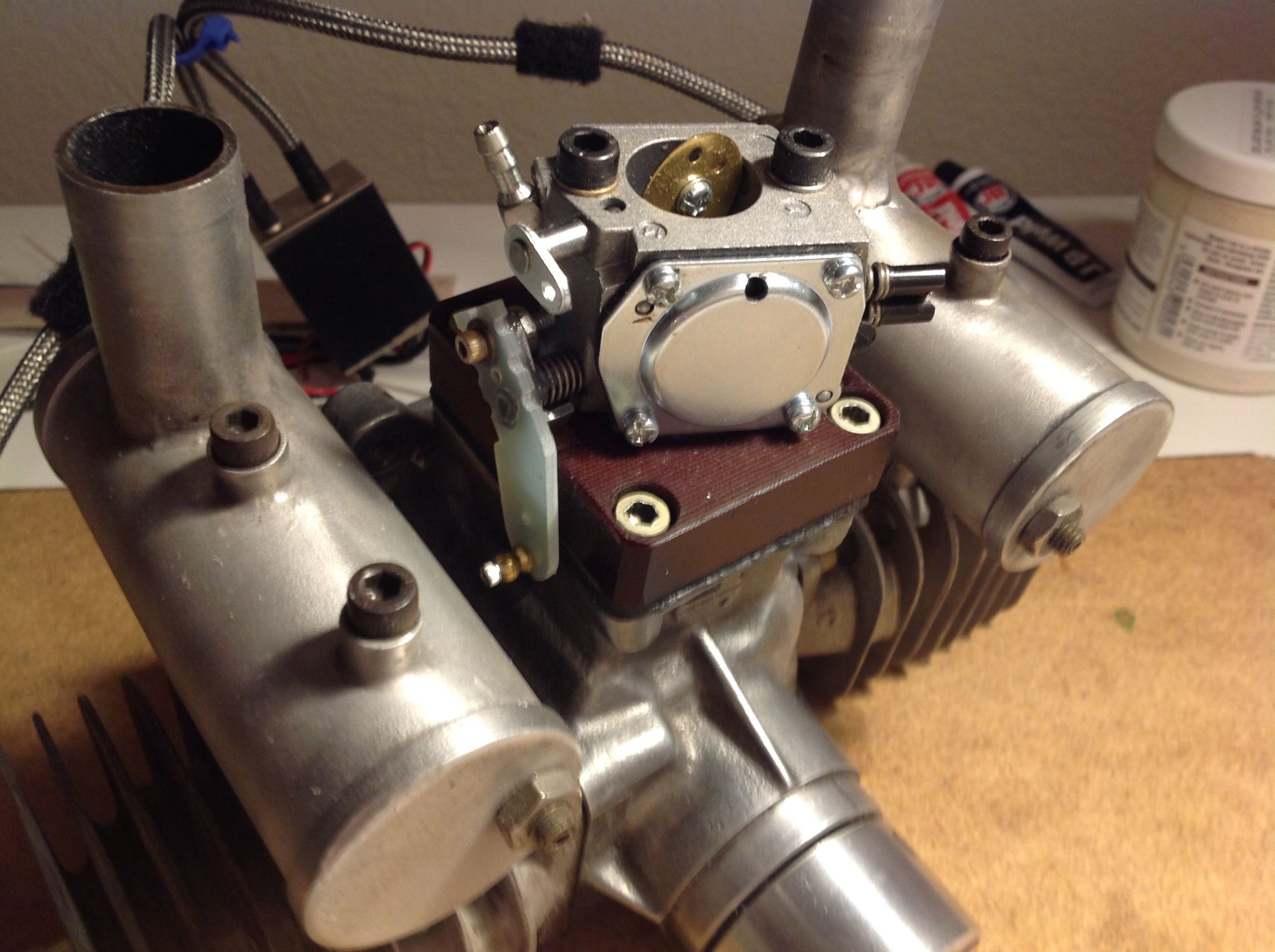

A FAR better solution is to set up a throttle linkage that will do the majority of this for you, THEN use a throttle curve for final trimming.
For our OP, I would add that when it comes to a plane that seems to be hard on it's landing gear, is the effect a forward CG has on a plane's ability to slow down while still maintaining good control (they won't!). The CG too far forward plane has a tendency to come in fast and use way too much runway - which invites trying to slow the plane down by dragging the gear in the grass. You can get away with flying like this on a .40 size plane, but when the planes start getting up into the teens for weight - this is a plan that doesn't work so well, regularly wiping out/removing the landing gear. Great Planes Super Sportsters were pretty well known for this. The factory "starting" CG shown in the manual was WAY too far forward (2"?), and when guys coming up through the ranks of smaller to bigger planes tried flying one of these 15-16 lb planes while still used to their .40-.60 size rigs, they had a terrible time - until somebody pointed out the CG issue. The plane was easily capable of tail wheel first landings regularly when set up correctly....

Yea, as Al has stated most do. The secondary issue with these carbs and their short arms is resolution. I don't like throwing analogies out there but imagine at first driving a high power car in the snow with only 1/2" of petal travel. Now take the same situation and give the petal more travel ( throttle curve ) but you now have 6 spikes in power due to low resolution. Now set up that car with 3" of petal travel and an infinitely proportional power delivery. Don't anyone take this as me being irritated because I'm not, simply putting free information out there that took me years to learn. If people choose not to follow the advise then I just move on to helping the next guy. That said, I beleive between the video I posted of my 150cc Extra and the take off scores with my electric pattern airplane that my methods work. I do however find it funny that a couple guys from the AMA forum are questioning this. Perhaps it's because there isn't much of an audience there lately?

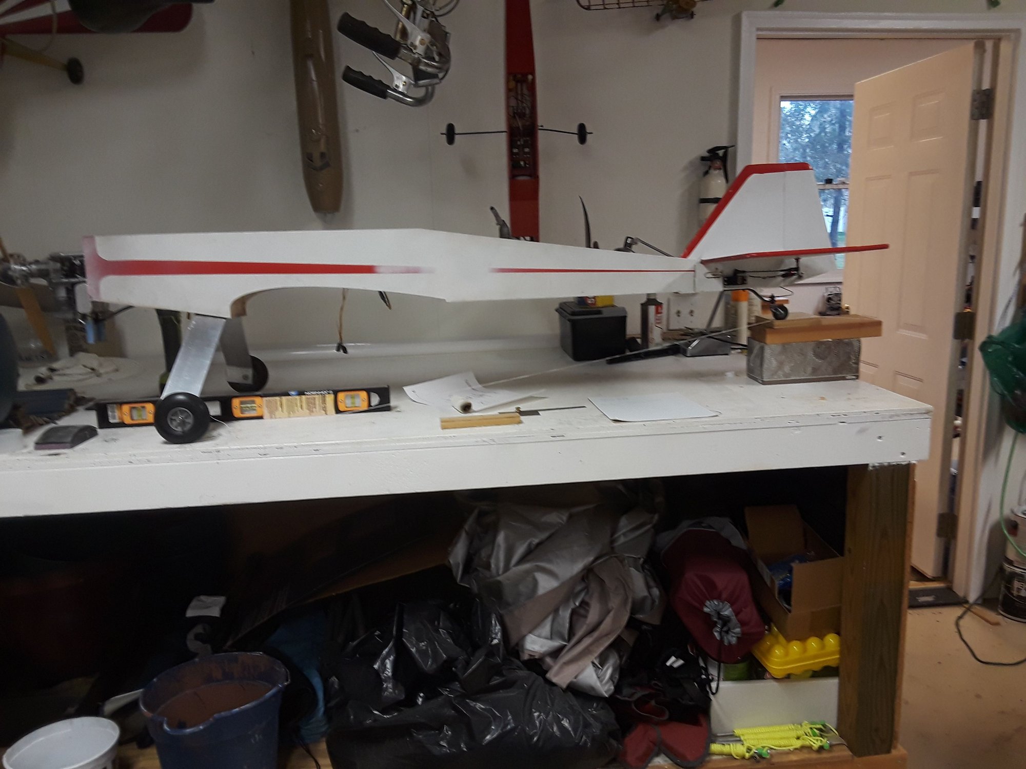

Default measurements
low wing stick level on table
These are the measurements
The original method used to measure the distance of axel to leading edge of wing was incorrect. It is 2.5 inches in front of wing.
There have been three different tail wheel assemblies on this airplane. The current one is probable worst case.
The servo arm and the throttle arm are the same length Just over 5/8 of an inch.

The main gear is a bit far forward, not terrible though. I can't get a very good view of your tailwheel linkage, perhaps a closeup of that would help. Things I would still like to know: how much rudder throw are you running? How much expo on rudder? What wing cord percentage is the CG?. It would also help if you took a picture of the nose from the top.
Your throttle linkage is a 1:1 ratio between servo arm and throttle arm. The throttle arm only needs to move around 40 degrees to go from idle to 85% opening. With your throttle travel volumes set to 100 the servo should have close to 90 degrees of travel. That is more then double of what you need. My suspicion is that you have your throttle volumes set to 50% or less which effectively cuts your resolution in half. Even worse you could have a large gap in values between high and low. Could you look and see what your throttle travel volumes for high and low are and let me know please? A few pictures of my own. As you can see the gear on my 1/3 scale Reed Falcon are a bit on the forward side as well. Also pictured is the throttle arm on the 70cc twin. Another picture shows where the travel volumes are adjusted to. I do a throttle curve that somewhat acts as expo to soften throttle response around center.

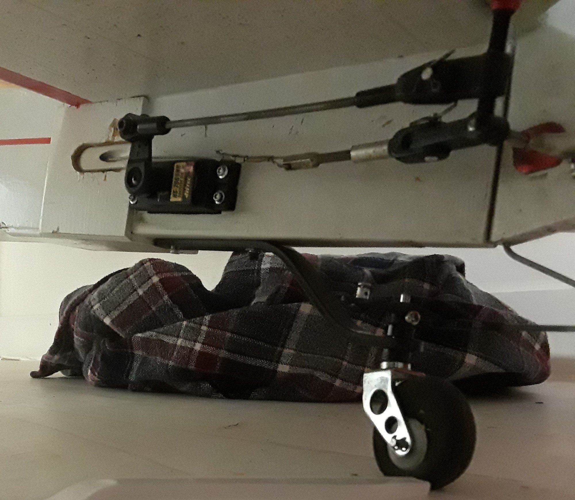

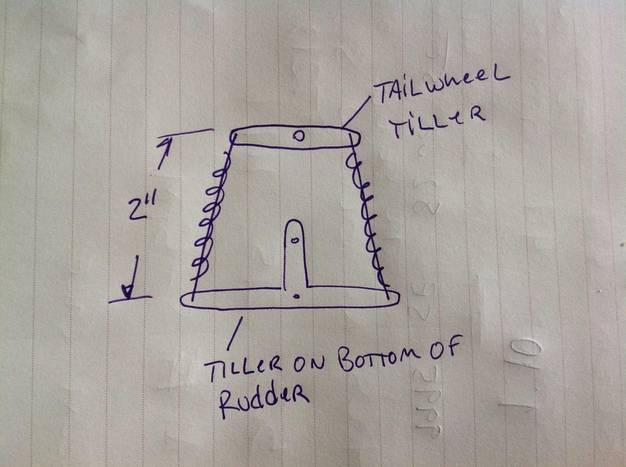

Default tail wheel assemble
The tail wheel pictured is the current and forth iteration of assemblies. Tail wheels with soft springs, hard springs, two springs on each side, no springs and no tailwheel just a slide. This one is a hard connection. The wheel has a flat spot from being slid sideways. Holding up elevator to keep the tail wheel in contact with the ground does no good, It just wipes the tire right off the rim.

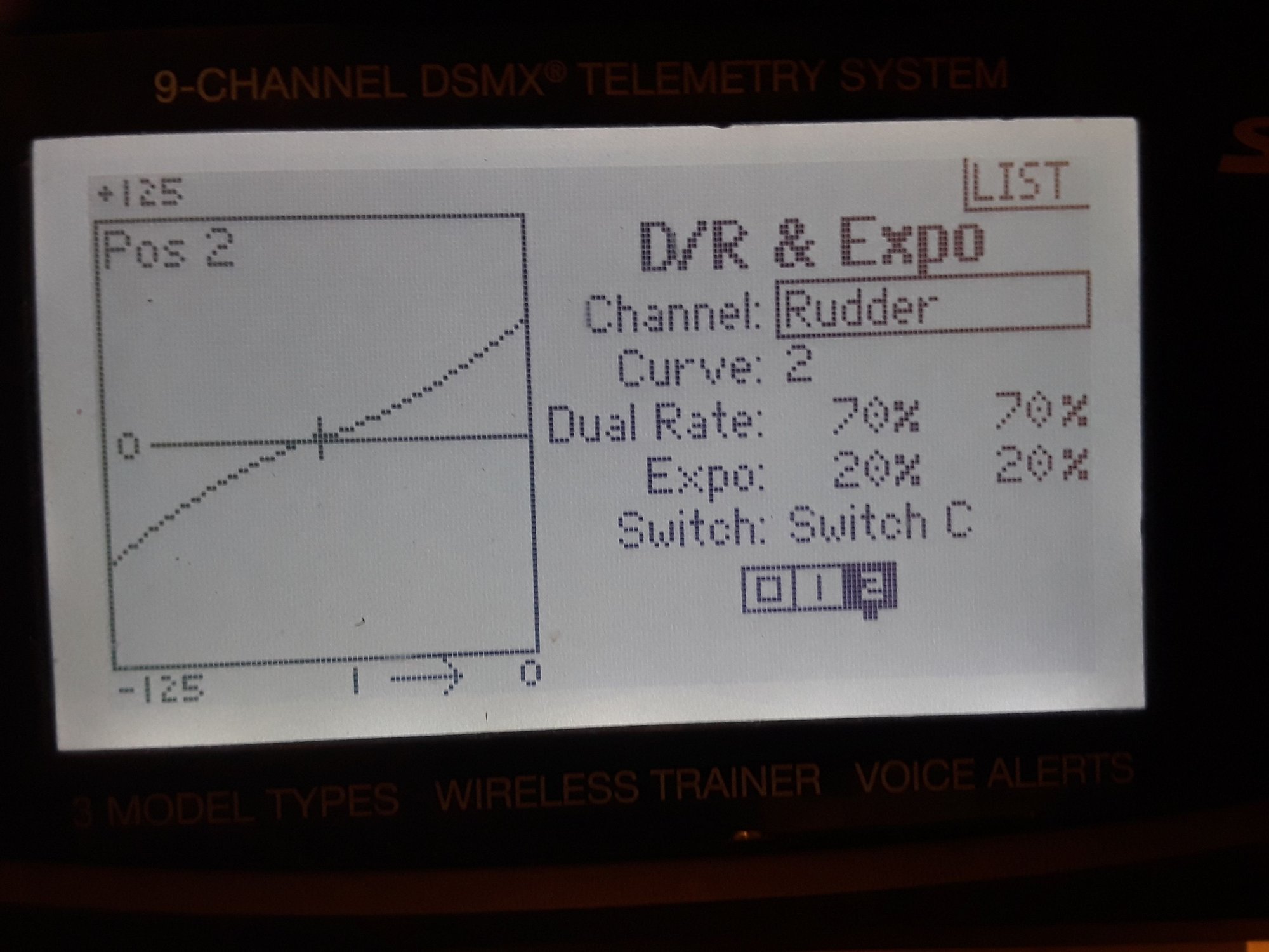

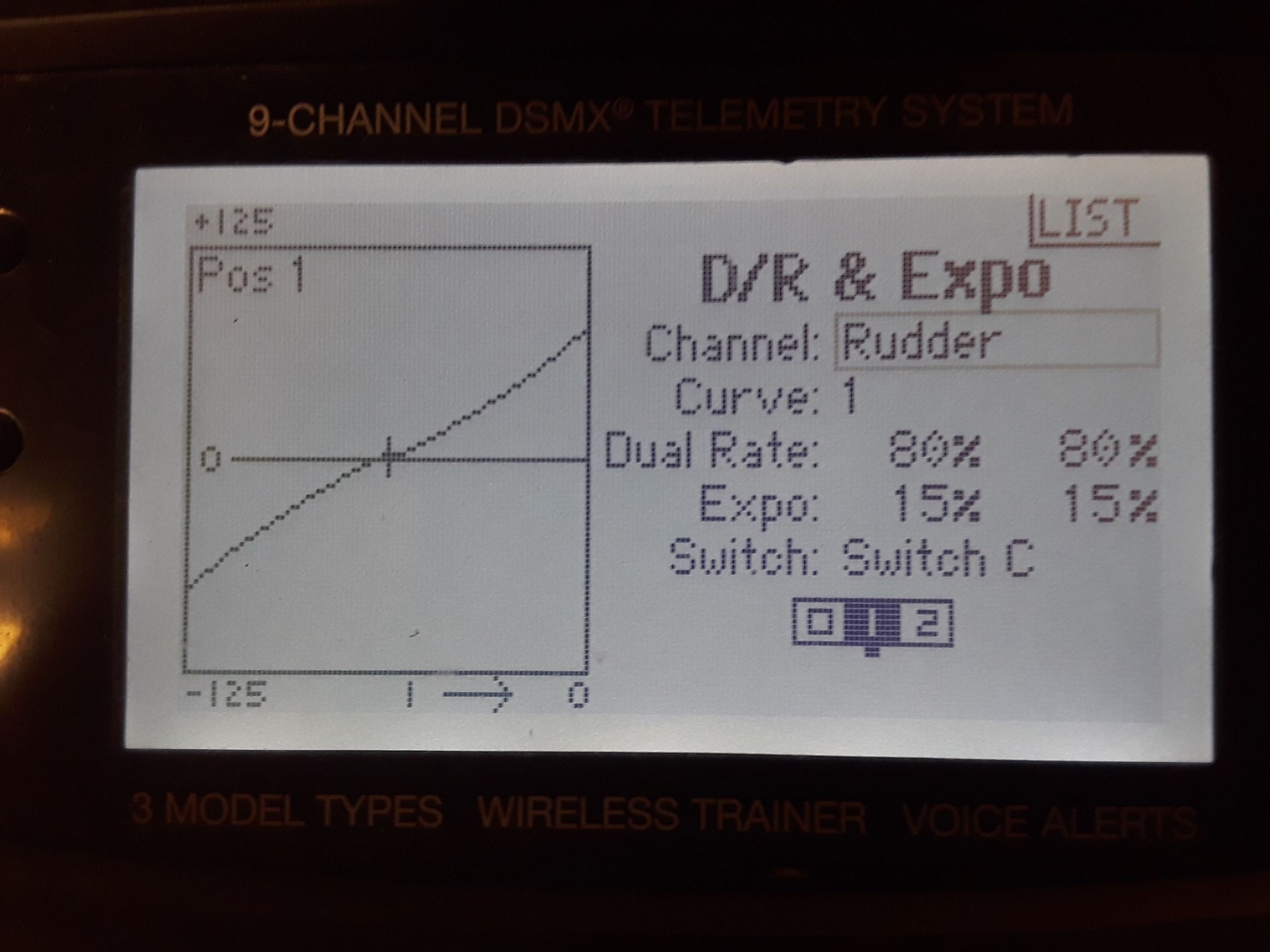

Default rudder expo
The rudder moves 2" at 100%. 1 3/8 at 70%

Default CG
The cg is 5" from leading edge of wing. Cord is 18". The CG is marked on the fuselage but it did not show up in the image.

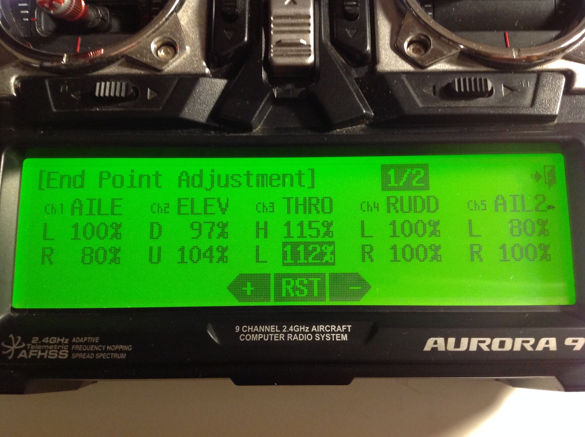

The throttle curve softens the low end more than the middle. The servo moves 90*.
Throttle closed to fully open is 90*.
2 1/2 " axel forward of leading edge of wing does not seem good. The next time I go to the field a more aggressive throttle curve and another landing gear will be used.

I see a bunch of issues with those pictures. First off your rudder pull pull cables are slack. This means that around center stick you have zero rudder/tailwheel control. This is going to setup a time delay of when you actually get some result from Stick movement. Part of why you have that situation is that it appears in the picture your rudder horn pivot point is well in front of your hinge line. If this is the case you may have loosened the cables at center to keep them from being puller overly tight due to the offset between the hinge line and the horn pivots. Ideally on a pull pull setup the clevis hole in the control horn would line up with the hinge line. Then the servo arm and control horns would be the same width but not absolutely nessesary. This would really help in keeping the cables tight throughout the entire movement.
The next item is probably more of an issue. You can't run a hard single linkage on a tailwheel like you have. The tailwheel strut will flex and that in return will create a directional input. If you look at your picture, the wheel looks straight. When the airplane is at rest with some weight on the tailwheel the strut will flex up and introduce a right input. Holding up elevator with airflow over the tail ( taxi and take off ) and you will be applying more downforce which will input even more right input. My suggestions going forward is to sort out your pull pull cables or move your rudder servo to the tail as your CG is currently very conservatively forward. Then fabricate a tiller arm shaped like a T and install as per the drawing. Those alone will go a long ways to solve your issue. For a complete fix, moving the wheel axles back some either with a new gear or by installing a wedge between the gear and fuselage and my throttle linkage fix. IMO 1:1 servo/throttle ratio is still far from ideal.
